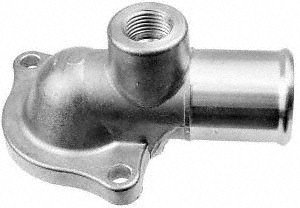

lol, yeah I figured he would have answer by now, but what-ev...
so far from what I can see, every picture of the 22re in an 85-87 has that housing...
I dunno, I may be onto something...
I might just try to order one at the parts store, and if it's the right one I'll take it, and if it's not, then I'll just return it and go back to looking elsewhere...
yup, or worst case, take the new housing and get a bung and have it tig welded in.
true; the only reason I haven't done that to mine already is because it's the only one I have, and if I screw it up, the truck's me DD and I'd be screwed till I can get another one

haven't checked them yet... since I get off work at 3:30 on mondays, I'm thinking about riding over to Cocoa Auto Salvage after work to see what they have. I havent been over to that place in about a year and a half, so I don't know what they got... Use to be a nice place cause they would let you bring your own tools, walk around and find what you need, and pull the stuff off yourself, but now it's walk up to the counter, tell em what you need, and wait... which is retarded if you ask me; half the reason I go to junk yards is the hunt!
But I dunno about that either cause I went ahead and ordered a new one for an 86 at the parts store in hopes that it's the right one. It should be here either tomorrow or Tue. Wish me luck on that guys!

well 96red, I went to Cocoa Auto Salvage today, no luck... like you said they have the runner; actually he said they had 2; one with the 3.0, one with no motor in it...
so then I went by Quarno's off Camp Road... they had 2 runners, both with no motor...
the housing I ordered at the parts store came in, and to my surprise, yep, it's the same thing on my truck now... no sensor outlet...
so luckly I got an old school guy at the counter who, get this, PICKED UP A BOOK! we looked for a few minutes, then low and behold, Factory Air part number 85020
in the book it claims to fit the 1.6l motors in the Corollas, and it looks a little shorter, but ya know what I'm at my wits end and damnit it's worth a shot, and if it'll bolt up and not leak, I'll be more than happy...
but it wont be in till Fri, so I let you guys know then how it works out; cross your fingers!

Well, that's cool because I hit two junkyards today looking for a supra. No joy on the supra but I found a ton celicas and believe it or not at the last junk yard I found 12 toyotas in row and half were second gen runners, 1 first gen and couple pickups all 90's. Not one had a whole 22r-e!! I did score the wiring harness for my brake mastercylinder low light FINALLY! If I need a cv joint I know where to go!!!
