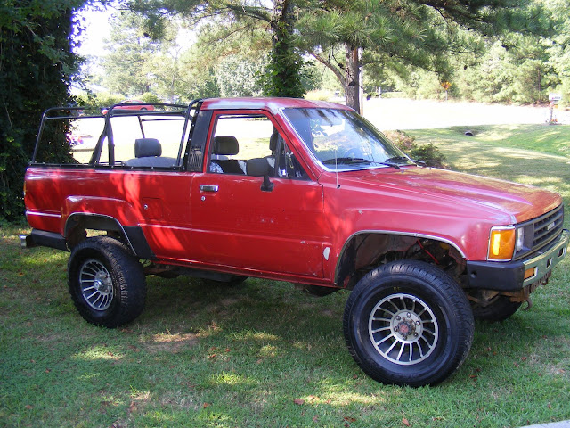

Pick up my first 4Runner late this afternoon
#41
That has got to be the best looking 1000$ rig I've ever seen. Man I have to admit that I hate red rigs but that thing polished out so well that I may have to rethink my evaluation. Jesus I wish my blue one could look that good!
Well done!!!!
Well done!!!!

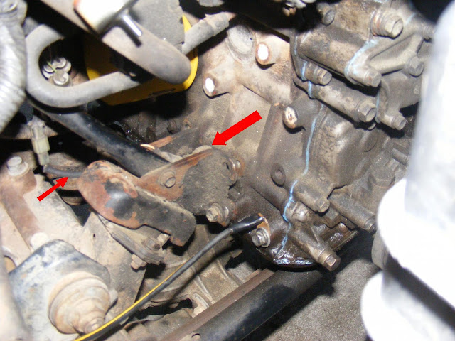

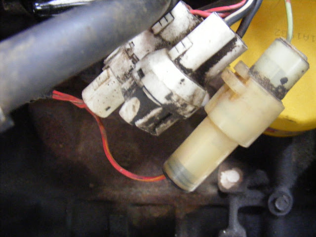

Here is a pic "updated" with the wonderful red arrows showing the location of the sensor (and the wiring running to it). I'm thinking this is for the oil pressure light ( which would need to be changed for a dash upgrade ) but getting to it ( IF this is the right location ) DOES NOT LOOK FUN!
#44
Ahhhh I see now...Could be Oil Pressure. I'd look at mine but its raining quite hard and I don't have a garage as of yet...I'll check tomorrow sometime.
I don't like the look of the mount though...

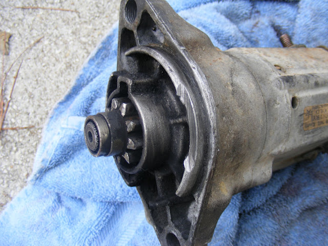

OK.. so the fun continues... MODS please let me know if I should post this as is or not..

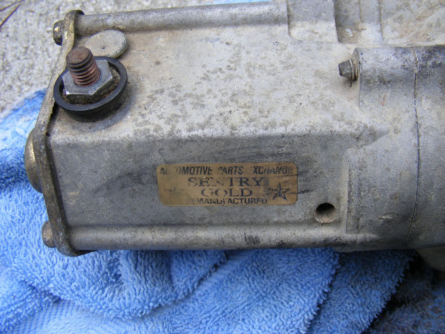

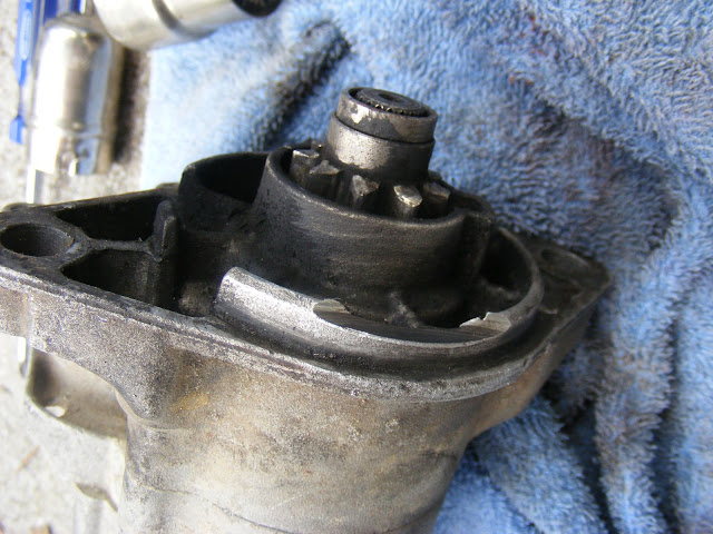

so today after a cleaning up the interior no cranky again.... so based on suggestions of earlier I removed the starter for a clean-up of "the contacts". Unfortunately, I have not done any repairs on starters in quite some time.... here is what I found for a starter...
This just didn't look right or make me feel any better about my non-starting 4Runner or what might be inside the starter....

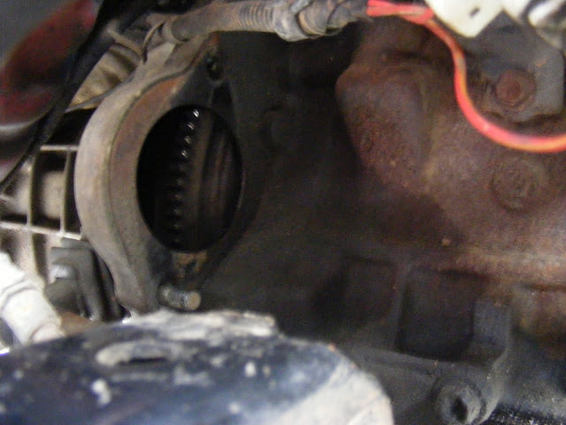

Here's a look at where it came from....
Not too bad... no real visible scaring to give me the idea that the damage to the starter was done by this engine...
#46
wth?
who's been grinding on the starter???
lol
good job on the buffing by the way
oh and that oil pressure sensor that's located inside the motor mount; on most pickup and 4runner applications, that hole is pluggged off and the sensor is here, just back from that hole and right under the oil filter:
lol

to continue.... not remembering well what to tear apart first I went for the "top" portion. I was fairly certain that this was the location of the brushes. The problem was I realized that I had no electrical cleaner... OK so here you go I cleaned the the entire deal with throttle body cleaner... OK sit back down.. nothing exploded... not that I wasn't worried but heck.. everything was geasy and oily like crazy...so I cleaned the sheout out of it all... as best I could...let it completely dry before re-installing and then the booger fired right up...

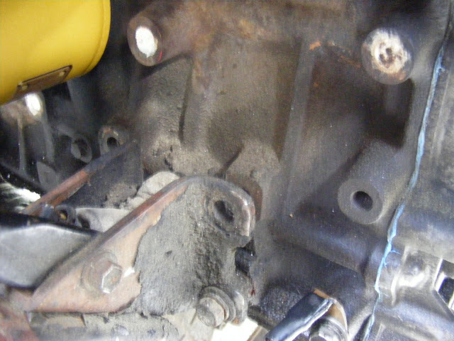

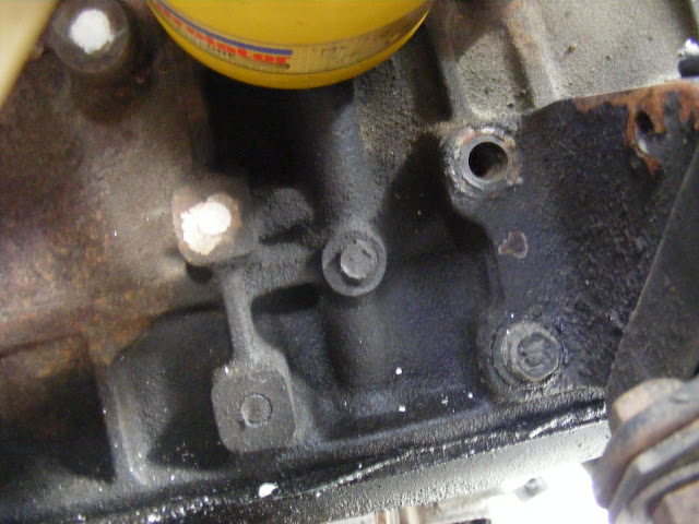

SB Thanks!...well here is what is in that spot on mine....
and here is the lastest... OK what should be plugged in here... I'm assuming to make me feel better that the one missing is for the A/C compressor....
and here is another shot of where my sensor is located... for now...

maybe the motor was pulled from a Celica and put in the Runner?
or the engine was just rebuilt and the sensor and plug mixed up where they go?if it bothers you it's an easy fix; just swap their spots
oh and I would DEFINATELY suggerst putting some bolts in those top mounting bolts
and that picture of the plug-ins, are you talking about the center plug?
it's kinda hard to tell...
the AC compressor plug is a single wire though, that I can tell you

OK.. first off I guess I should thank everyone for their positive comments and feedback..yes I suck for not having done that sooner... after the starter tear down yesterday I just felt I missed something... well I was right... I should have remember reading this before but I've tried to be a good newbie and maybe I just have read tooooo much... so maybe some other newbie will read this or even some one researching their own STARTER REBUILD or CLICK CLICK CLICK issues... JUST GO HERE and LEARN
http://www.4crawler.com/4x4/CheapTri...OnlineOrdering
Now I feel like a fool... but I know I can do this now AND I'll be better prepared.. Heck I just might rebuild the entire thing AND since my 4Runner has the starter relay (remember me mentioning this thing looked like it had been smacked a time or two itself) I'm planning to do the wiring mod to send the battery voltage directly to the starter!

The white crap in the holes is not the result of human folly. It's a wasp building a nest inside the unused holes. Very common for engines that haven't been run for extended periods of time around here. If you dig them out, you'll prolly find a dead larva inside.

First Up... Starting problem. Well after ordering a starter re-build kit ( new contacts, plunger, isolators ) I yanked off the starter again and went thru what I thought was what was needed the first time. BUT... NOT. Same thing. I am SO LUCKY.

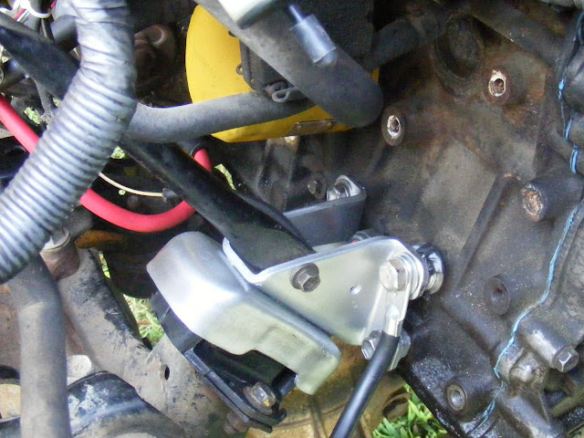

So since that didn't help and I knew the next stage was the wire cut shown in the earlier diagram I had also picked up a set of motor mounts and took care of the ugly thing on the pass side ( nastily displayed in a prior post ) and here is the finished product...
Even found some 2 Ga positive and negative cables from a prior project ( 84' K5 ) which also found themselves put into action.
