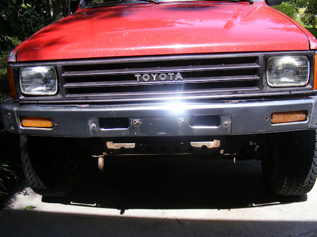

OK... so the blue wire in the pic above poking out next to the headlight is my hood latch "helper" I wrapped it around the release cable and use(d) it to pull the release from the outside whilst I attempt to slam the hood shut. Sometimes it has worked other times.... yeah no. I even thought... the cable needs to be down tight... there is too much give and that is another reason it's not latching correctly.

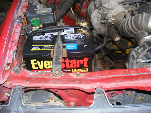

as far as the battery hold-down....got mine from EBAY......make sure the battery is on it's little plastic tray too.
when we picked up our 88 4runner the battery was WAY too big and not anchored at all and there was evidence of it sliding into the fan as well (3vze)....the fan had melted plastic all over it and the battery was gouged out.

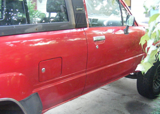

back door opens like this...............roll down the rear window with either the key at the back gate where it says TOYOTA or if you have a window switch inside, roll it down. then,when the window is down, reach inside the rear gate and pull up the lock button to unlock it and then there is a handle to open the gate.
if you are missing parts (door handle), take all the inside trim off the gate and there should be 2 cables (one from either side) that you just pull to release the gate.

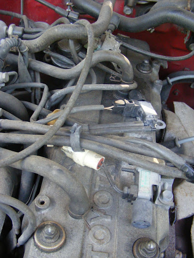

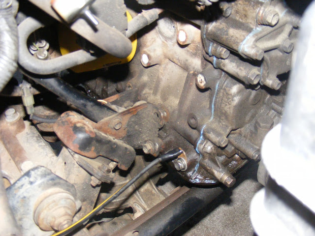

OK.. so the deal with WHY did it take the oil filter that wasn't listed... along with.. IS that sensor SUPPOSE to be mount INSIDE the motor mount?? And lastly I guess the best way to figure out what size the motor mounts bolts that are missing are to take one of the others out and use it to size with. Is the engine mounted wrong? Is it some car motor? It does say 22RE right on the front yes. But I'm confused/just wanna know what I really have.

Yes, looks like the timing/water pump cover has definately been off. And I have NO idea why they would have packed the white crap in the holes where the A/C compressor goes. It runs.. OK.. .nothing great. Has a "noticeable" tick. So I'm thinking adjust the valves which from what I've found is pretty straight forward and should be fairly easy. I figure if I could do my Cosworth Vega ( shims, digital mic, half a dozen special tools) I can do this 4 cyl.
