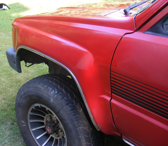

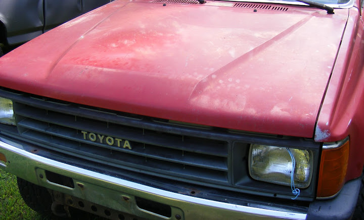

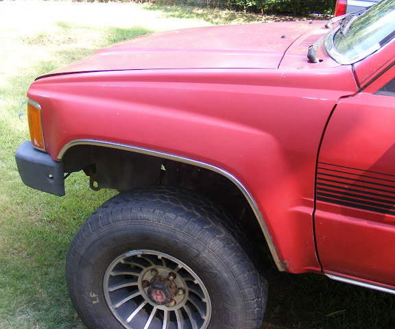

So here was the workout action... OMG could I have picked a hotter afternoon...just wanted to see what a little buff action would give the paint...
Before and....
After....
Drvr Fender Before...
and then after...

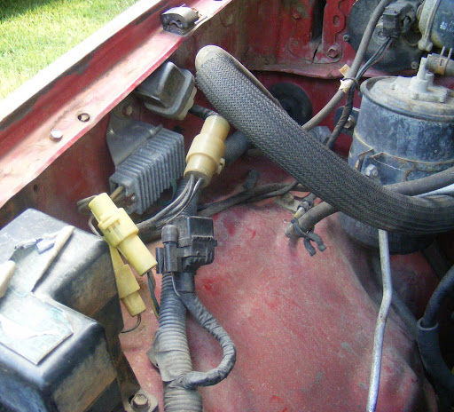

it almost sounds like this relay is clicking... and oddly enough this thing looks like it's been banged on a time or two...am I onto something with this??
I've went out a couple of times over the evening and it started both times.
the one right at the fender/hood line... it's marked relay something something.... and being the newbie I am I'm still trying to read all the "read before you post stuff attempting to figure it out...

Dare I ask about the blue string hanging from you drivers headlight?

The electrical part in the picture above is called a solenoid resistor, is cotrols the voltage going to the injectors. The one on my 86 4Runner went bad and it wouldn`t start, i had a used one and put it on and that fixed the problem. I think its a dealer only part, and im sure its expensive.
