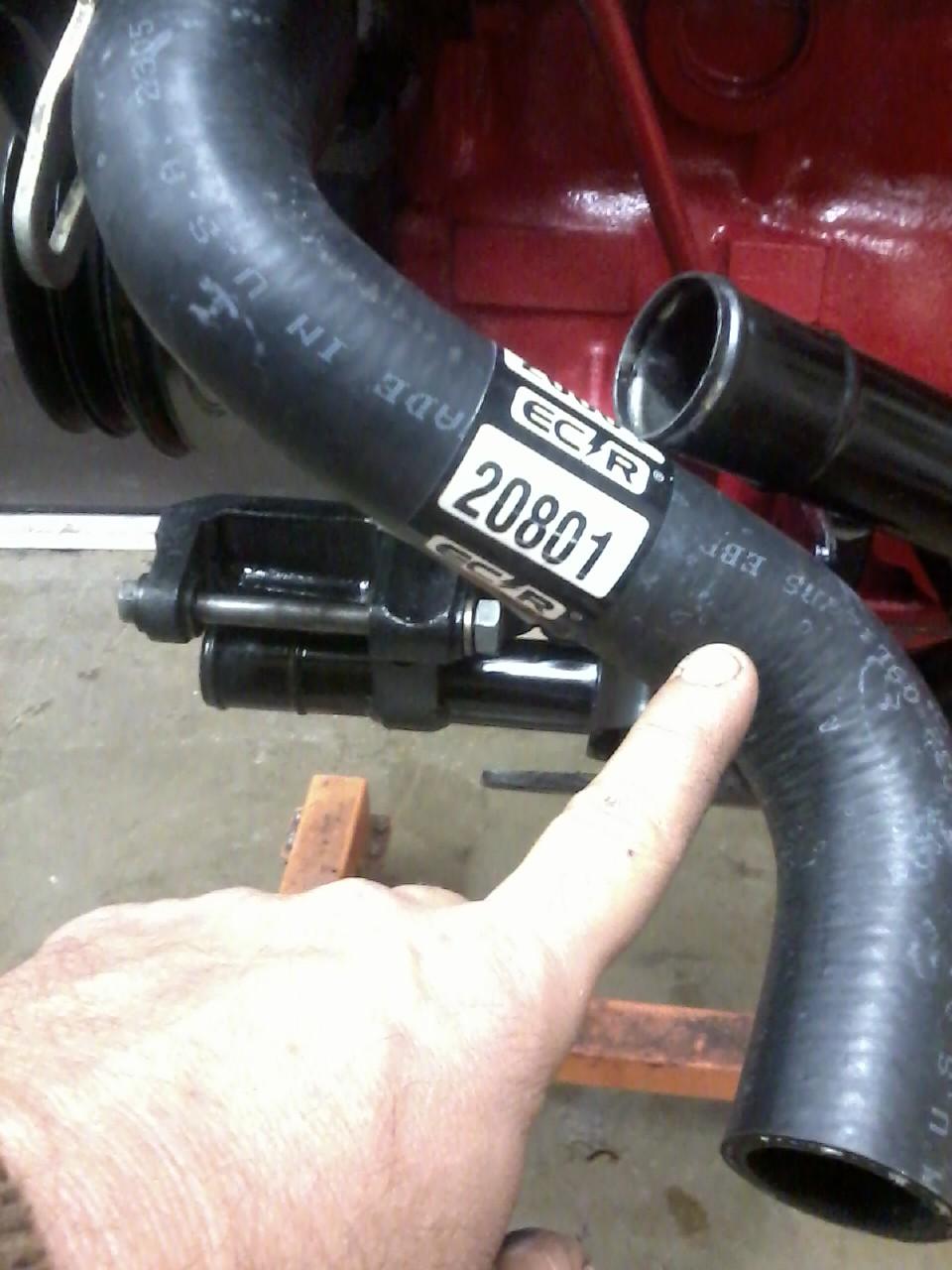

The water pump hose can be a pain to get to when everything is back together and would suggest changing it while you have it out along with the oil seal on the distributor.
Copied...
Parts store will tell you this is a dealer item or they dont stock it. This hose likes to leak coming off of the water pump when it pops a hole. Gates PN#20801, just cut off where my finger is at. Alot cheaper then the dealer.

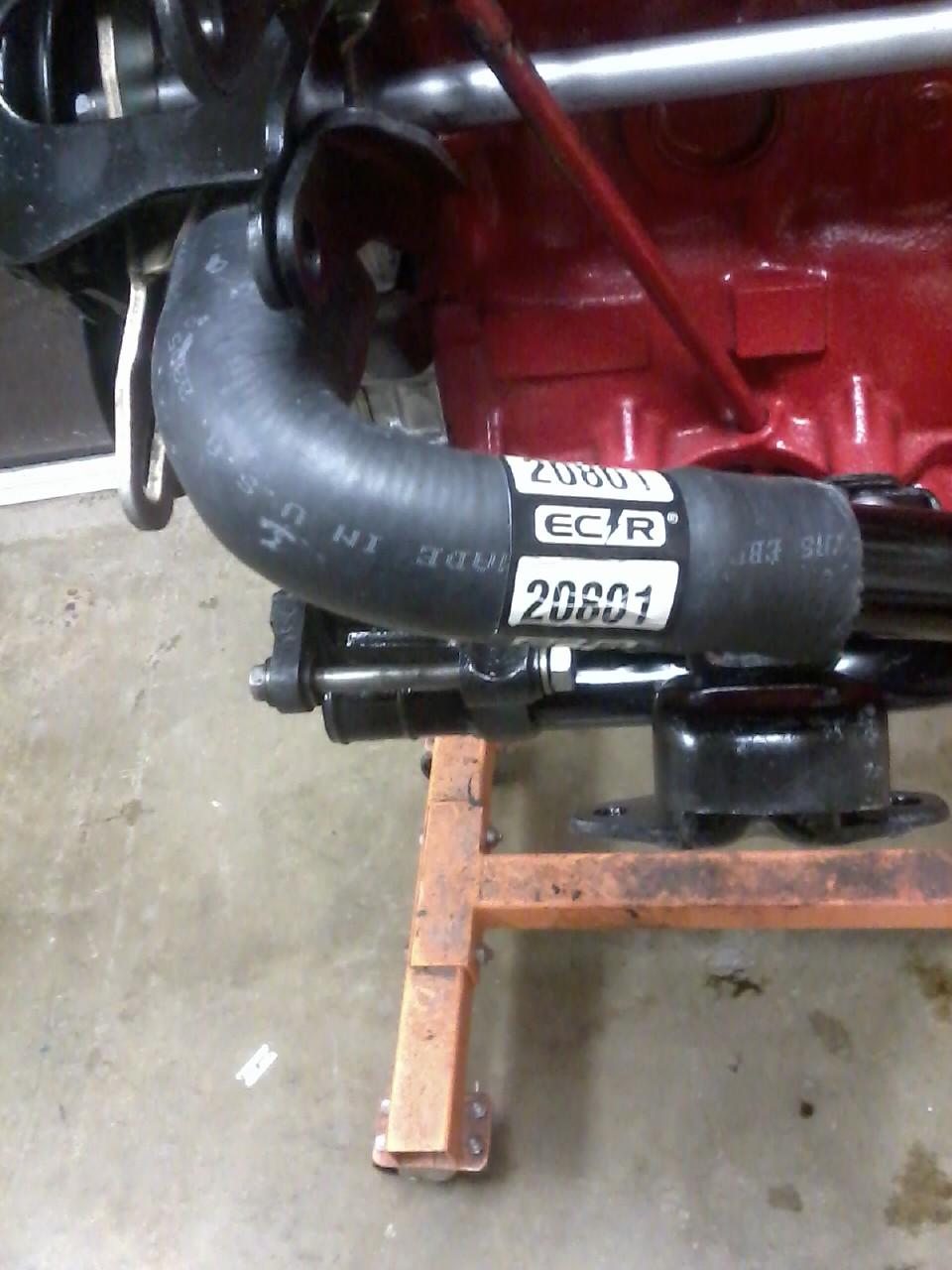

Here it is cut to length and on. I need to get some new hose clamps to finish the job.

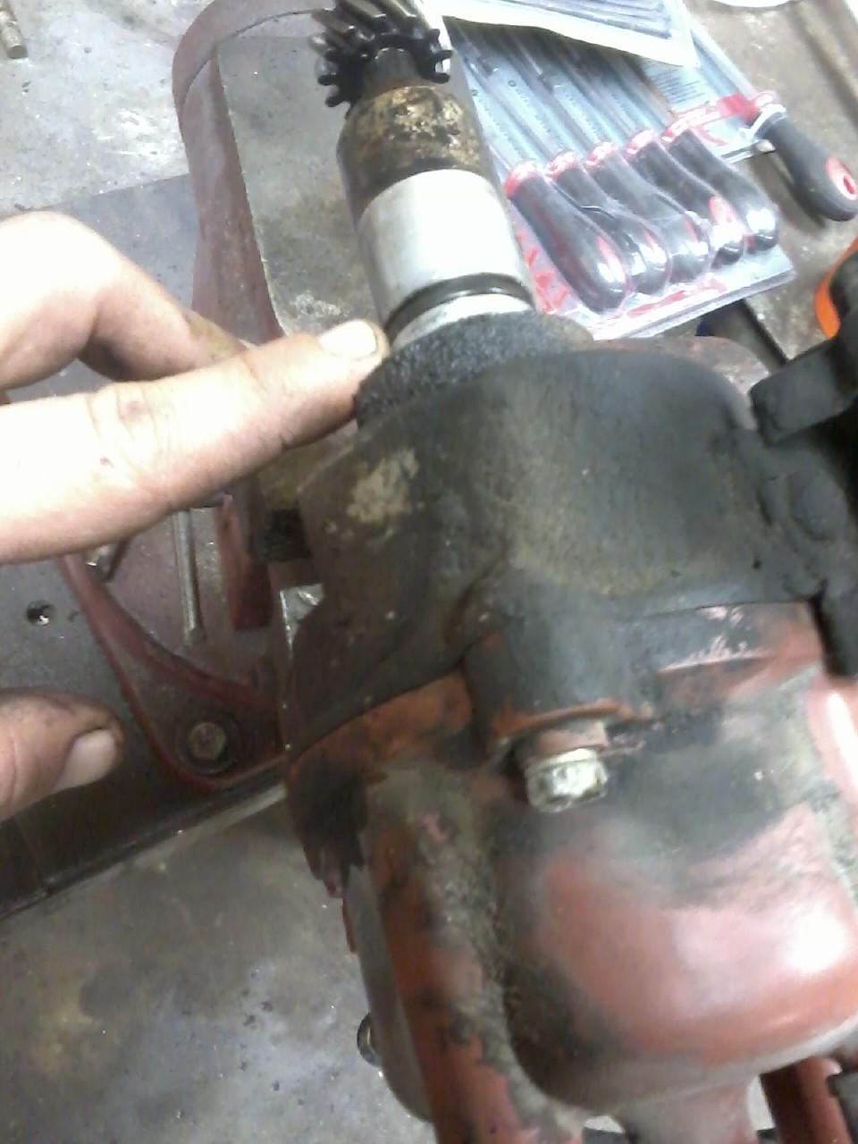

Seal is dry and hardened. Reason for leak. I have a seal for the dizzy cap as well on order for Toyota.

Replaced with a seal from Orielly for .96 cents. The old one will most likely break when you go to remove it. One less oil leak now.

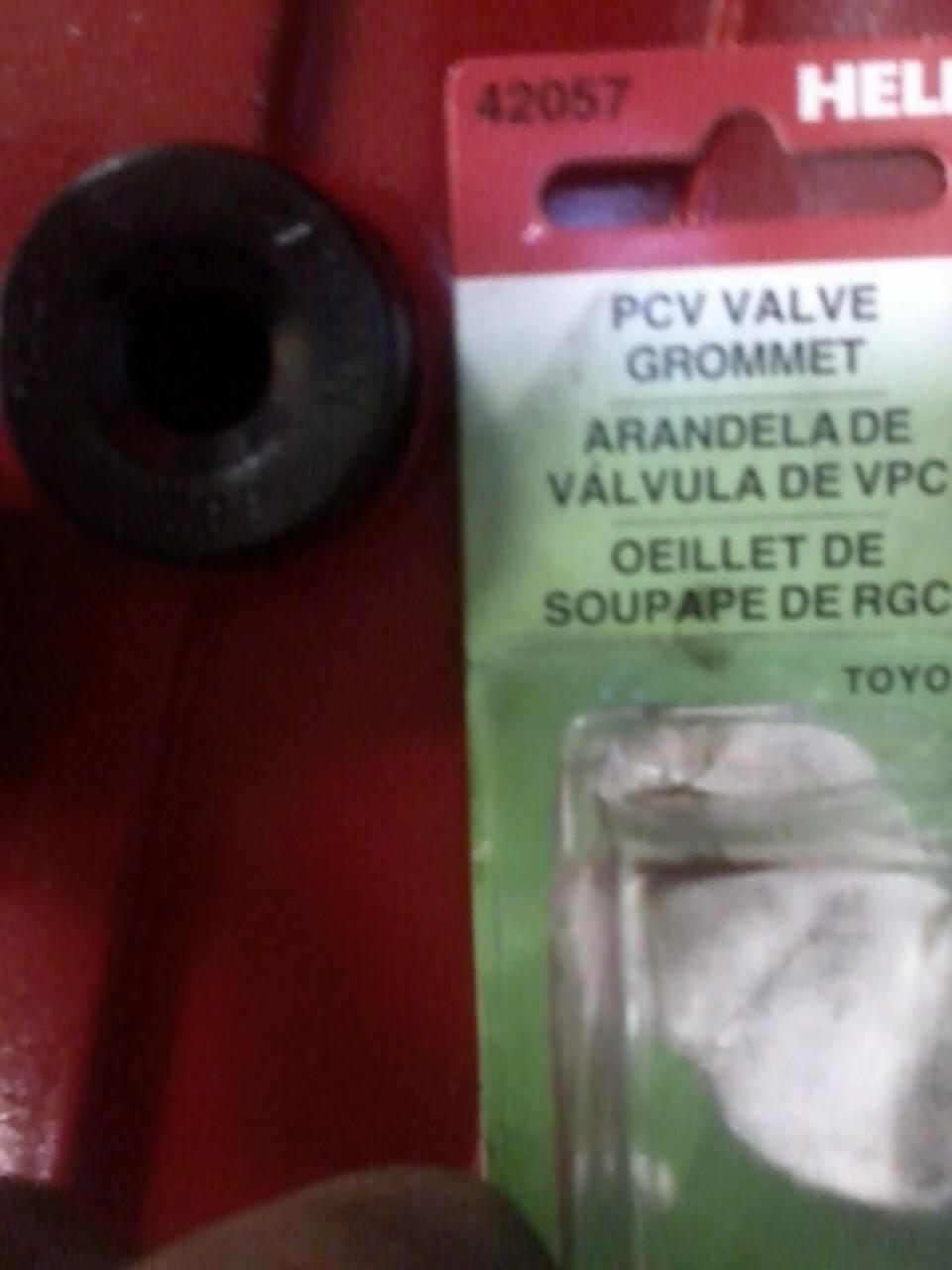

When doing regular maintainace, change the PVC and I change the PVC Grommet as well as it will harden up and wont let the PVC come out or break and fall into the head. I change both out at the same time.
