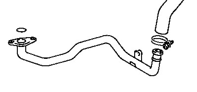

Forgive me for hijacking your thread... but my ignorance has the best of me. I read through the first 2 pages, but did not find what my brain lacks.
Can you tell me what this pipe is called? I believe it to be a heater pipe and think it attaches to the intake and I need to read up on what to use (gasket/fpig?). I called toyota parts dept here and there diagram shows nothing going there... I'm finding that hard to believe so reaching out to you for expertise!
Thanks in advance
Thanks in advance

I hope you don't mind me trying to help you out here, but I think that is what they call at toyota a Water Heater Inlet Pipe Part #87208-14280, and the FPIG Federal Poverty Income Guidelines...Haha just joking... I believe its an O-ring 96711-24017, I used an o-ring there, but add just a little RTV to make sure it doesn't leak. i hope i'm right, but here's what I am talking about hope its the same that you are thinking about.

That's correct!
It's a dealer part and cost like $3 - but you want to get it! I smeared FIPG (also dealer part - totally worth it) on the flange mating surfaces.
It's a real PITA to get that pipe separated, gasket installed, then mated up again, when you have the head on.....doable but patience is a must. I ended up replacing the 2 bolts with studs, threaded them into the bottom of the intake, and used them as guides to slip the pipe flange back on once the o ring was installed. Studs also reduce risk of stripping I believe.
Other thing I learned: if you're replacing the head, make sure you install the EGR cooling plate on the back of the head BEFORE you install the head - that was awful - I snapped a bolt, and replaced the 5 bolts back there with about 2" of space between the head and my firewall.....

Wow, you guys really helped an old man out! I spent 2 hours this morning trying to find the name of that pipe in the fsm, message boards etc. I'm going to take your advice on studs too. See what toyota has when I make a trip down there with the part number you gave!!!! I learned the same lesson about that plate in the back. Pulled the engine back out and did it before putting it back in~
That's correct!

00295-00103 (seems to to be the most common one)
00295-01281
