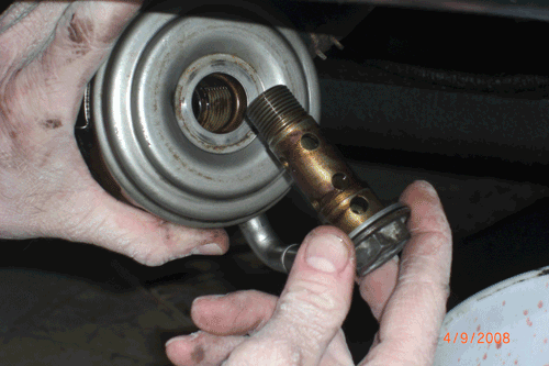

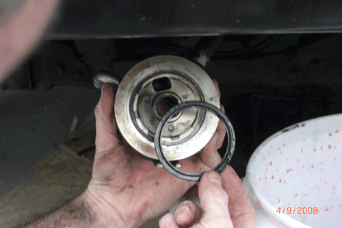

I took the plunge this past Wednesday and tore into the Oil Cooler on my 1994 4Runner. It took me about 4 hrs to complete the job and some busted knuckles but for $12 bucks it was worth the experience.
I felt the most difficult part was reattaching the hose clamps since I was probably using the wrong tool to crimp back the clamp.
Oh, one other thing I forgot to do was buy 2 containers radiator fluid. I ended up spending more money in gas driving back and forth to the dealer ship.
It has been a good 15 years since I've worked on a car and I must say I'm glad to be back! This was my first major accomplishment on my 4Runner and now I'm ready to move on to the abs light problem. Again thanks to everyone for the help.
I almost forgot to say the most important point to this exercise, "NO MORE OIL LEAK!!!!"
