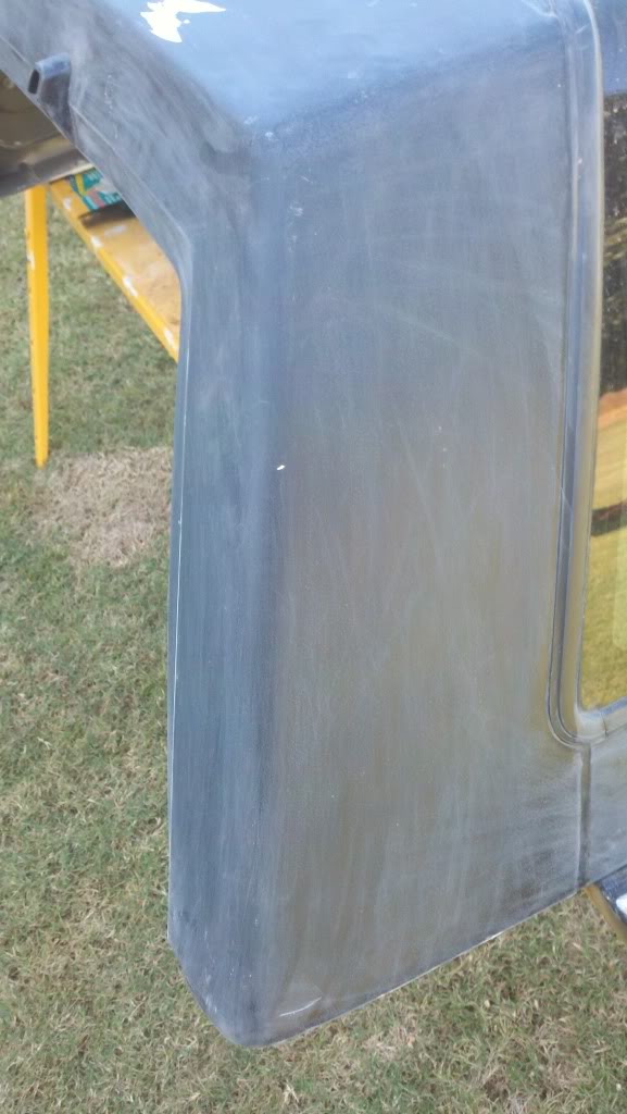

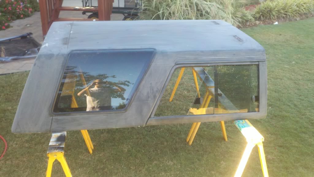

well i started sanding with 180 grit. i started with a air sander and quickly relived that it was not going to work. Have a few deep gashes from the sander. Then stared to just sand it by hand.
sanded with 180
i have never sanded anything so not sure if i sanded enough i wiped the dust off with a sock and it turned out like this
u guys think it is sanded well enough? All i was doing was pressing the sand paper with my hand I know most people use a block so should i get a block and go over it aging?
Old Oct 7, 2010 | 07:18 AM
  #49
Swimmerboy2112's Avatar
Joined: Apr 2010
Posts: 4,835
From: Walnutport, PA
I'd get a block and do it again just to be sure.
Old Oct 7, 2010 | 07:19 AM
  #50
Keyser Söze's Avatar
Joined: Feb 2009
Posts: 19
Looking good. I used 220 grit for mine. Sanding by hand/block is probably best for fiberglass. You just want to rough-up and even-out surface so that new primer & paint will adhere properly. Fix any gashes or they will really stick out later.
I mentioned doing a clear coat before because after a year the satin black I used faded into flat black, probably because the paint lacks adequate UV protection. I have had absolutely no problems with chipping or peeling.
Old Oct 7, 2010 | 07:52 AM
  #51
richf's Avatar
Joined: Jan 2009
Posts: 477
From: Moyock,NC
The point of sanding is to remove loose paint and rough up the surface so the new paint has something to bite into. Make sure nothing is shiny when you finish sanding. If you have some scrap 2x4 you could make a block out of it if you don't want to buy one. I use a dewalt electric random orbital on big flat surfaces and sand by hand on anything that isn't flat. You will be fine will the air sander as long as you keep it flat. Guys that build boats in carolina sand fiberglass boats all day long with mechanical sanders so you should be fine.

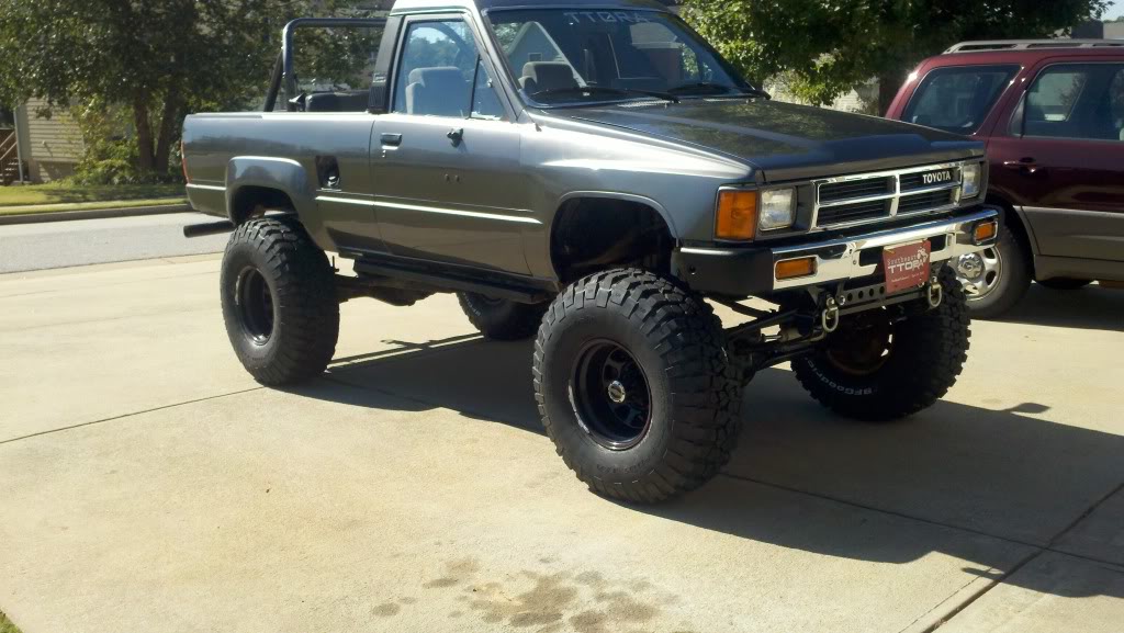

on a side note i just got these on today
35x12.5x15 KM2 going up to 37 MTR later work at a tire store so get them cheap
