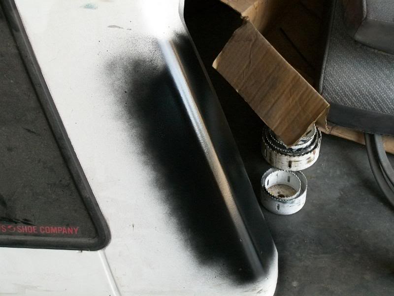

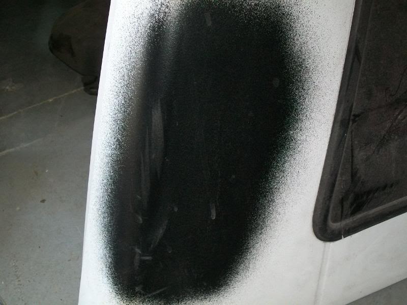

I just sprayed two areas on my top to show you flat and satin black. Give me like 10 minutes for the surface to dry and I'll take a picture.

This is duplicolor bed liner I sprayed a couple months ago
This is Krylon Fusion satin black I just sprayed
And this is Krylon Fusion satin black vs. Rustoleum camo flat black

wow man could not ask for a better reply lol thanks alot. Am thinking the Krylon Fusion satin black is the winner for me.Here is my new plan
1) sand with 220 sand paper
2) Clean and wipe with the cloths
3)prime with two or three coats.
4)wetsand with 600 grit
5)Wait for it to dry then hit it with some Krylon Fusion satin black thinking 3 coats or so.
Thank you richf and Swimmerboy2112 helped me out a lot might start sanding tomorrow any other info would help alot or any thing i should add or do different in the list above
