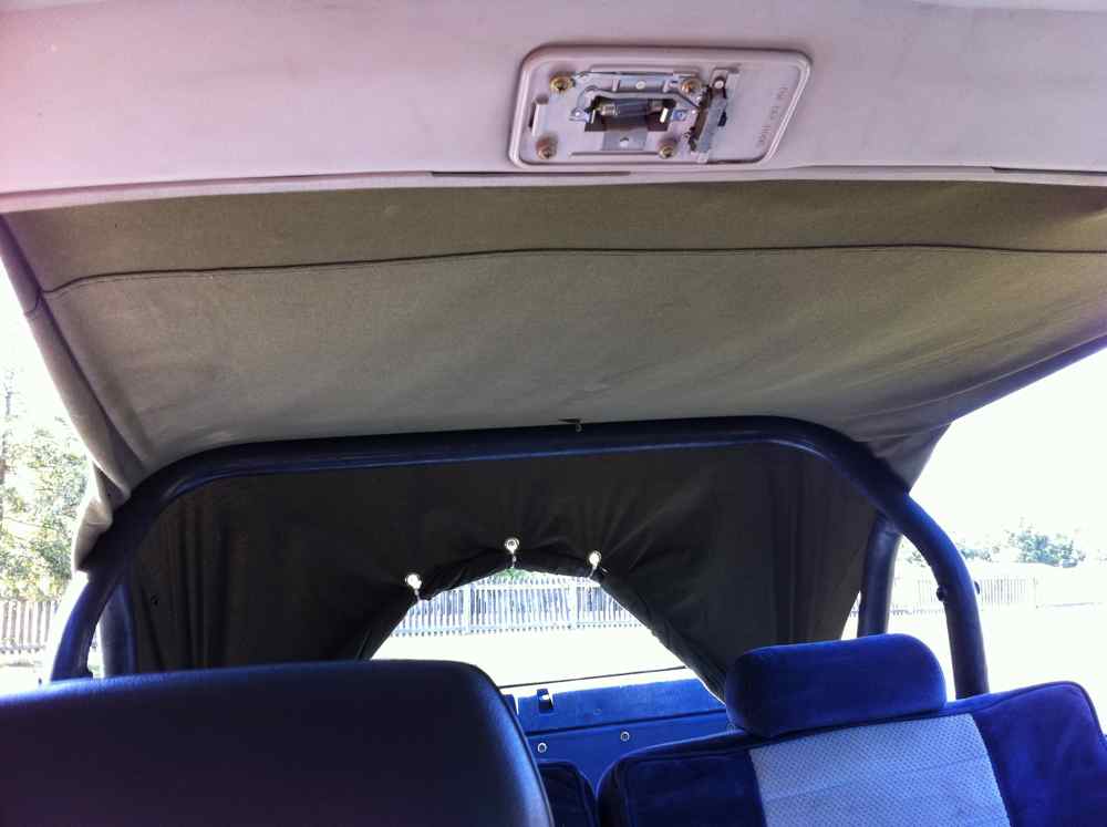

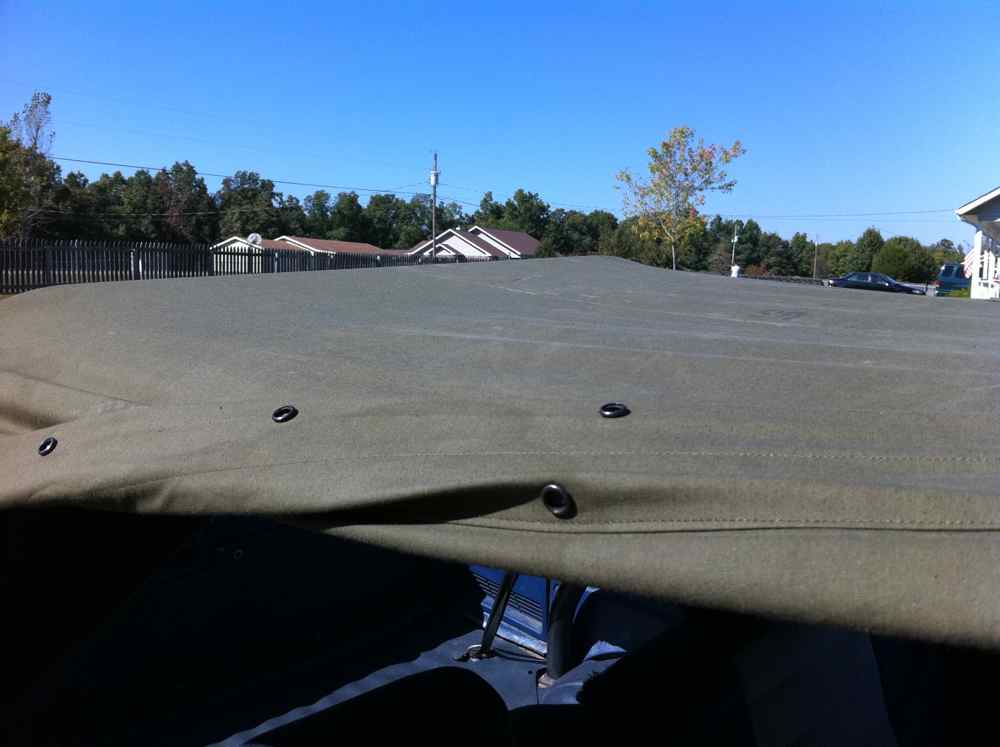

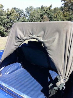

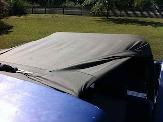

I made a bikini top for mine for around $30 with a military surplus tent.
Old Oct 6, 2010 | 12:02 PM
  #38
nlinn's Avatar
Joined: Feb 2010
Posts: 56
From: Fayetteville, AR
here you go
Attached Thumbnails Painting 1st gen 4Runner top-img_0667.jpg   Painting 1st gen 4Runner top-img_0668.jpg

a couple more
Attached Thumbnails Painting 1st gen 4Runner top-img_0669.jpg   Painting 1st gen 4Runner top-img_0665.jpg
