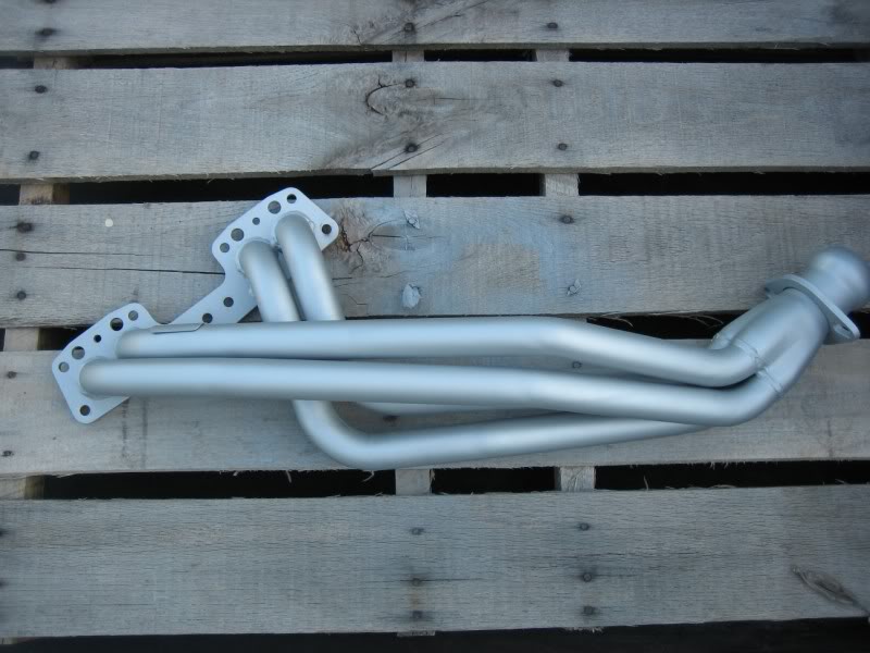

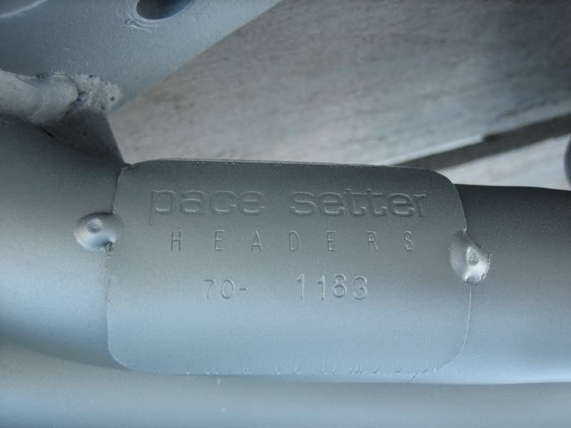

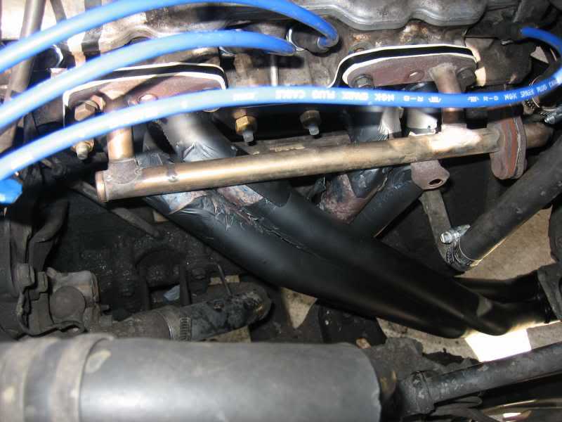

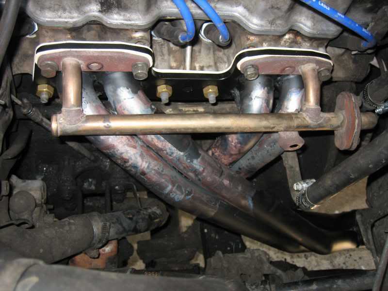

agreed; save your money and get a better one
1) the paper gasket they supply with them is CRAP. a stock manifold gasket with the metal heat shield removed was the only thing I could get to seal up
2) the black coating they put on them is a total joke. it burns and flakes off within the first 10 minutes after starting the truck up with it installed
3) you CANNOT get all of the holes for the PAIR valve tubing to line up properly no matter what you do. my solution in the end was just to remove the PAIR system completely...
I ran it for a few months before doing a complete engine overhaul, and when I did I sanded and repainted the entire thing with high temp paint because A) it looked like crap, and B) to prevent it from rusting since it was just bare metal. It looked nice after that, but it still had leaking issues...

I read all this and thought long and hard before getting mine, but it was honestly all I could afford. My manifold was trashed and the downpipe even worse. My Pacesetter problem is that it hits the transmission where it meets the engine and is too close to one bolt. I just took it to Fesler Built and used an air chisel with hammer bit to pound in these two spots. In my opinion, if you are buying a cheap header like the Pacesetter (I read this info and knew what I was getting myself into) I say DO NOT buy the ceramic coating. I have it and have had to mess it up to make the header fit. Just get the painted version, make all the adjustments you need, and then paint it with uber high temp paint.
Iamsuperbleeder's looks great. Did you have clearance issues--by the pics, yours looks fine. I wonder if they sent me the wrong header?
