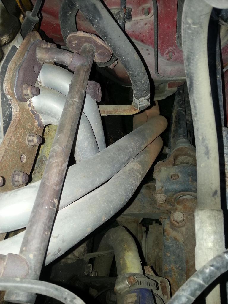

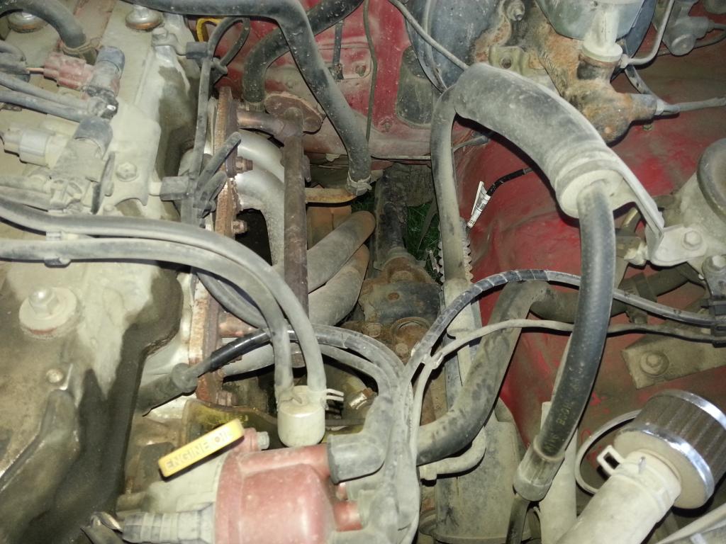

I have a header on mine but I don't know what brand it is. Previous owner installed it. Can get pics if interested.

It was a Cali truck. hence the extra vacuum lines and extra exhaust piping.

Does any one know what mine is btw?
