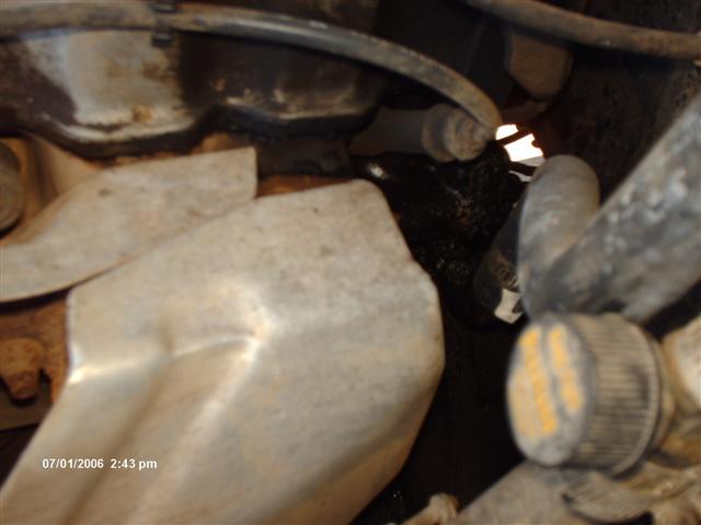

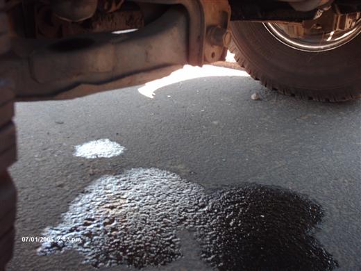

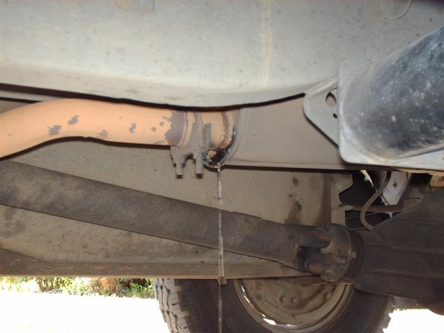

Ok so here are the pictures that I took tell me if you need more I can get them

wow i havent seen anything like that before...definately dont drive it until you fix it!

Pretty odd You can leave it up to me to do something like this,so should i still assume its a BHG or worse then that ?
