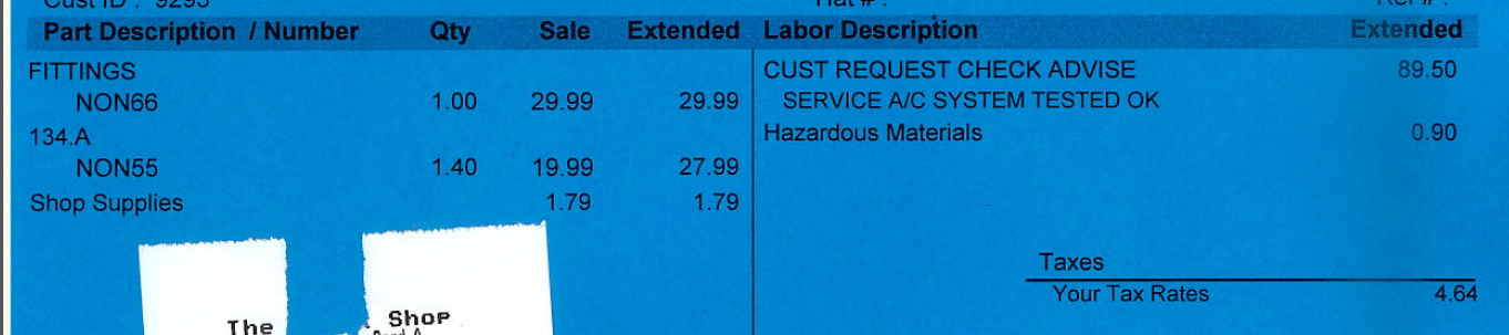

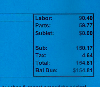

Conversion is not that expensive. No need for a whole now system. IIRC it only involves a few fittings and seals.
Attached Thumbnails Original A/C in need of charge-screen-shot-2017-07-13-2.02.25-am.png   Original A/C in need of charge-screen-shot-2017-07-13-2.02.14-am.png
