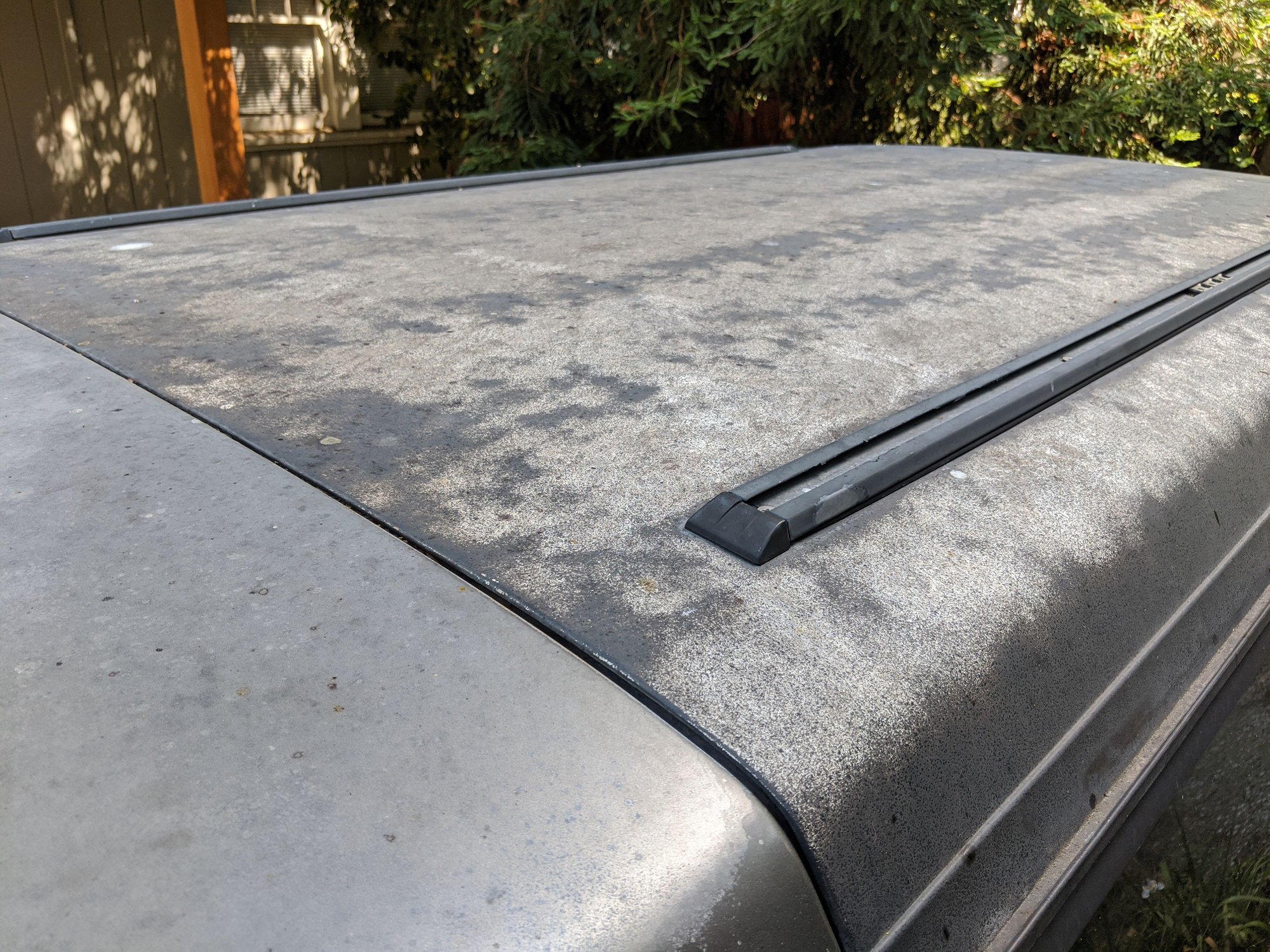

The fiberglass fibers are increasingly beginning to show through, and I'd like to protect the top against further damage. What are people's favorite approaches to this?
I don't want to repaint the whole assembly, as then it'd make the rest of the faded truck look even worse if the top becomes too nice or too dark. Maybe some charcoal-colored coating? Not sure.
Open to suggestions!
Sun-beaten top

I decided to go with the Rustoleum truck bed coating (black), and am pretty happy with the initial result. I do expect it to sun-fade over time, but even then I expect it to be better than it was as most of the horizontal gel-coat was gone. On the previously smooth surfaces (sides), it's now a bit sandpaper-like, but that helps balance against the rough finish where the gel-coat is missing.
My expectation is that it will sun-fade and need to be re-done every few years, but time will tell.
As for prep, I washed it with a standard car-washing soap, scrubbing aggressively with a plastic-bristle gong brush.
Before
After
