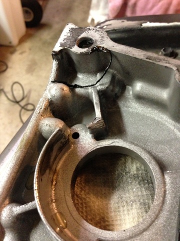

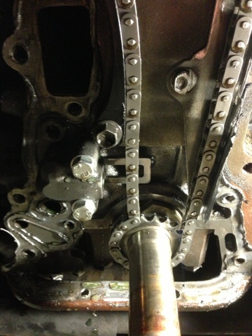

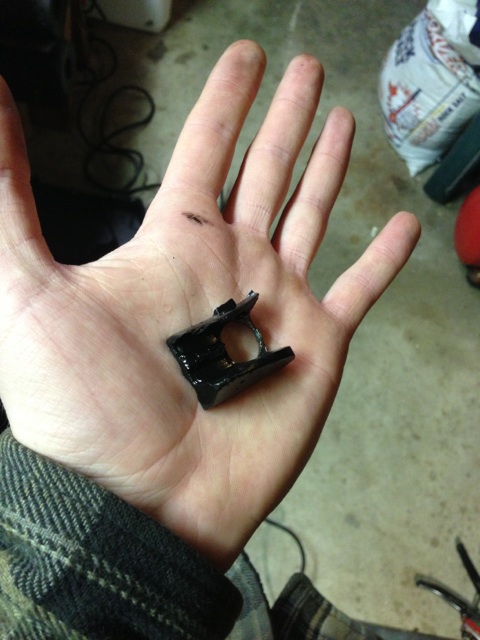

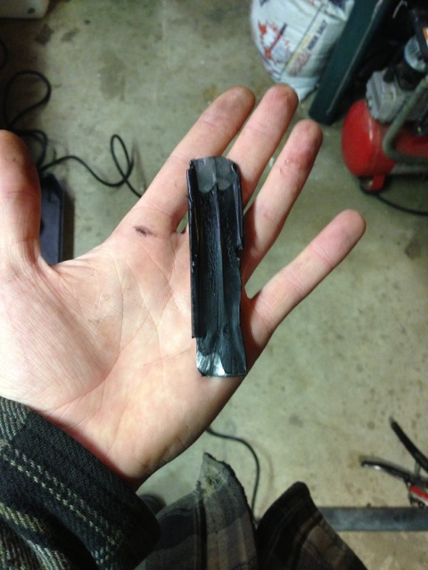

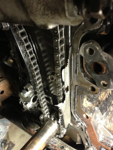

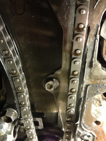

Here's what i found behind the timing cover.

The rest of the pieces are in the oil pan and various other places within the motor.
I spoke with Sunwest and have worked out a deal to get the engine replaced for free. Other than having to pull the engine once again, im pretty pleased with the outcome.
