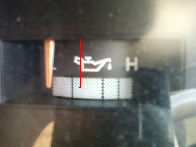

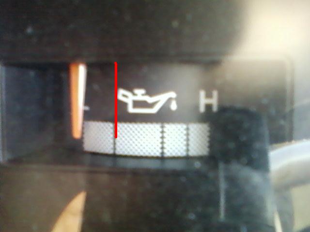

Here's the pics, all are with the truck at operating temp. These are just examples since I didn't actually start the truck. 1st one is at 2000 rpm, 2nd one is at idle

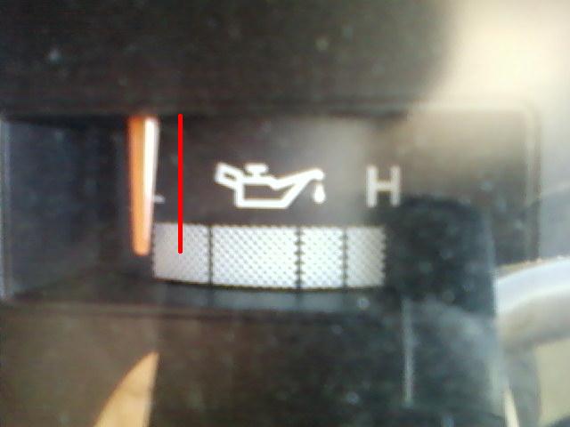

And these are when the truck has sat for a bit and was restarted, still at operating temp. 1st is at 2000 rpm, 2nd is at idle, see the difference?
