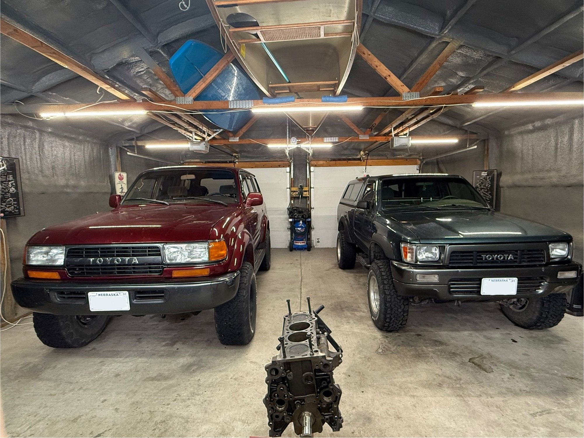

Hope this is in the right subform. I recently came across a used 3RZ that was pulled from a 4runner. It was cheap enough to where I knew to buy now, and ask questions later.
I've currently have an 89 Pickup with the 22RE and IFS. I've got everything lined up for the swap...except the oil pan. Ive done some reading and have a couple of options.
1. Solid Axle swap. Not really feeling it. I just replaced all the bushings about 2 years ago, and it rides really well. I'd hate to undo all that work, but if I have to, this will probably be the last ditch effort to make everything work.
2. Cut up the old 22RE oil pan and splice it with the bolt pattern. This will probably what I would consider option 2 if I can't find what I'm really after. I've heard of people doing this, but haven't heard of how it worked in the long run.
3. An oil pan out of an IFS Hilux with the 2RZ/3RZ. Part number 12101-75090. I've heard this is a plug and play situation, and works without body lifts or anything. Bad news is it's discontinued. I've searched hi and low for the past couple of months. Partsouq, Amayama, Japan4x4, etc. No luck. At this point, I'm just waiting for someone to find one in the corner of a warehouse somewhere, or let go of one from a previous project.
I'm throwing this out there to see if anyone has one of these pans laying around they'd let go of, or would know of any oversea's junkyards where one might live. If you have any other input as well, I'd be open to it.
Picture, because I've heard threads are useless without them.
