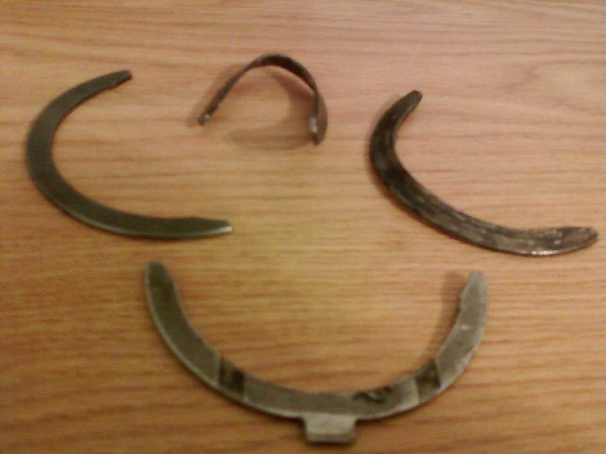

oil pan findings... what is it?
I dropped my oil pan and found some mystery parts. I have seen these before but cannot remember right now. Someone please identify!

Thrust washers? I'll google it...sounds familiar but I'm not positive.

yeah that's what I just figured out... doesn't look good

Yep, Them be thust bearings. Sorry dude, motor gots to come apart!

the thing that I don't understand is how they came out, what would cause them to come out?

your block is probably junk now.
Just time and parts wearing out! It happens to everyone if they keep one long enough!

I took the block and crank to the machine shop figuring that nothing was wrong with them, but it turns out just like everyone said they were junk. So the guy has a block that he is selling me and I just bought a new crank. So hopefully soon I will be driving my yota again.
