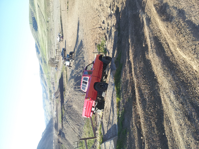

Was doing some climbing today, hit the front if the motor around the CS pulley.. she is leaking a lot of oil now.. it was full if mud as well. Washed all the mud away.. let her sit till its light out... anyone wanna take some guesses as to what I broke?? Haha.. we will find out in the AM..

Pretty sure I took a shot right to the pulley.. it is not bent or dented.. I drove it home and it goes down the road fine, and the pulley spins nice and smooth.. it just leaks oil... I will def look at the things u suggested under better light!! Thanks
