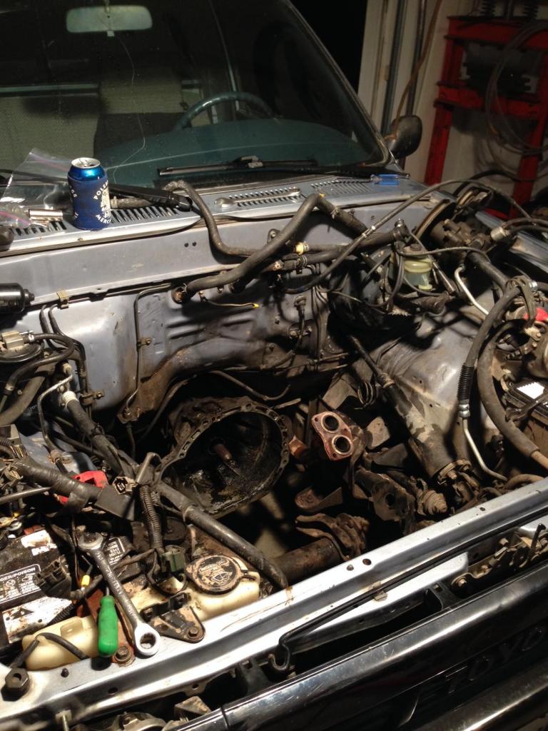

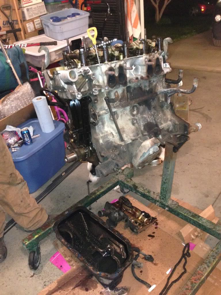

From: Wenatchee, Washington
And so it begins!
