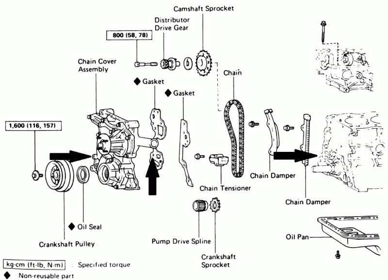

Kiroshu's Avatar
Joined: Oct 2007
Posts: 2,747
From: NC
Hmm.. seems to be running out of the lower timing cover bolt that goes through the Air Conditioning compressor bracket through the timing cover into the block... the timing cover gasket could be leaking/damaged internally/externally making its way down/around the bolt/fastener shaft out the engine...
Possible.
I would re-clean a double check.
Possible.
So I cannot see any oil above the Air Condition Compressor bracket. I have been all over the engine with my blacklight and can only see the glow of the oil from this bracket down towards the oil pan ( runs down the oil pan passenger side to the bell housing and drips down to the ground ) and it also drips down the AC bracket and down the differential and down the stabilizer to the ground. So probably the timing cover gasket like you said?
Its not coming from the filter or anywhere down the front of the engine. have to crawl under it and the highest place i can see it coming from is the AC bracket.
