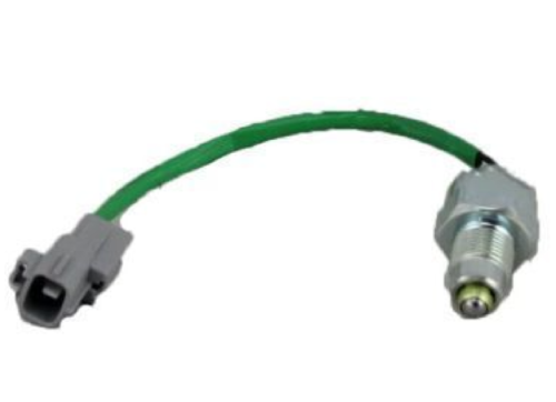

I assumed it was the same 2-pin connector as the reverse switch, so I bought a 2-pin Toyota reverse/4WD pigtail from Ballenger (https://www.bmotorsports.com/shop/pr...4aAhBVEALw_wcB)

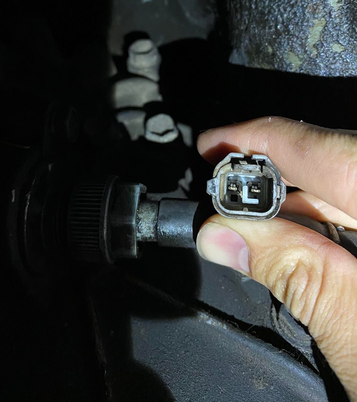

But, of course, when I actually crawled under the truck, I found something different:
I checked the Toyota RM1022E ("wiring repair guide") that's widely available online, and unless I'm mistaken, that's a male 2-pin plug, part# 90980-10580:
It's got the two pins, the "L" shape plastic keyway thing, and and open square hole below pin 2. The female counterpart that goes with this plug, again, according to the RM1022E, is part# 90980-10581:
But I can't find anything about either of these plugs. According to Amayama, the male part number only came on the Toyota Century...I find that hard to believe. The female plug shows up on Amayama as well, but it doesn't say what it's from. Searching regular dealership sites comes up with nothing, searching either of those part numbers in forums comes up with nothing. Ballenger only has the one pigtail I linked above, which is the correct pattern for my reverse switch (and looks the same as other 90's Toyota reverse switches I've worked with).
So, has anyone seen this plug before on their 2nd gen (or other gen)? Or is it from some other Toyota vehicle and a previous owner put it in the transfer case because they had it lying around?

Sorry, I guess I wasn't clear enough: that plug is not the wiring harness. That plug is a little 3 inch pigtail coming from the transfer case indicator switch. I would be tracing this (generic picture for reference):
No mystery as to where the wires go.
I just want to know the shape of the plug so I can buy the right pigtail.

Right, I’d love to buy the matching connector, but I can’t find it. None of them I’ve bought fit my transfer case switch. They almost fit, but that little “L” shape in the center of the plug you can see in my photo prevents the “suggested” pigtail from fitting.
I know I could cut it apart and splice it but my goal was to NOT have to do that. I (wrongly, I’m realizing) assumed it was a common plug shape I could just buy.
And I don’t feel like dropping the transfer case to switch out the indicator switch. I’ll just leave it unplugged at that point.
