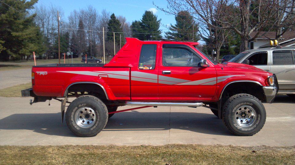

well im finally doing a SAS on my 89 Toyota got me a 85 solid axle with the front half of the truck frame on it.. gonna be a father and son project with my dad helping me.. as of right now I wanna strip the axle, repaint it and maybe add armor I wanna keep it at the height its at right now with 33s..
what are some good kits to use and i wanna go high steer and use my ifs steering box

do you have a picture of that front half truck frame? if this is a low-budget deal, I wonder how much of that can be re-used.

I have all winter I will post the stuff I'm getting Saturday when he cuts it out
