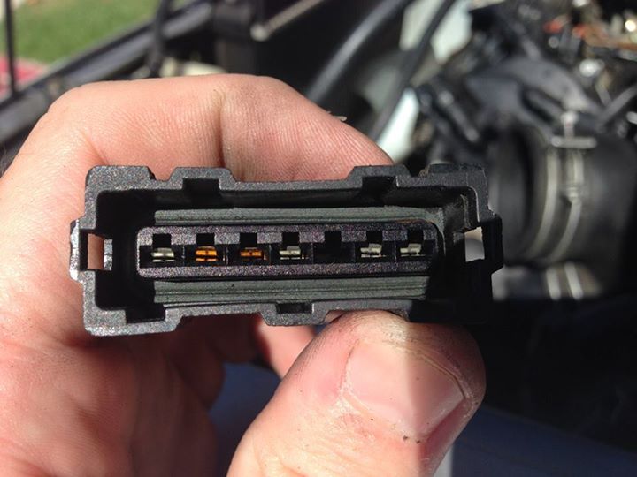

Here's where things are (to me) odd, when I pulled the VAF to check with my multimeter, the VAF itself checks out across the board (based on the FSM). When I went to check the connection (engine side), I appear to be missing what should be the E2 connection. I have all seven prongs (or whatever they're officially called) on the VAF side, but only have six wires and six "prong receivers" on the connector/engine side. *See Pic.
According the the FSM, I should only have six, but the "blank" hole should be the third from the left, when looking at the connector, not third from the right. O.o

...Here's where things are (to me) odd, when I pulled the VAF to check with my multimeter, the VAF itself checks out across the board (based on the FSM). When I went to check the connection (engine side), I appear to be missing what should be the E2 connection. I have all seven prongs (or whatever they're officially called) on the VAF side, but only have six wires and six "prong receivers" on the connector/engine side. *See Pic.
I wouldn't pay TOO much attention to that. First, the FSM shows the connector looking into the VAF. Your photo is looking into the connector going to the ECM. So your "pin 3" is third from the RIGHT, while the FSM shows it third from the left.
To make matters more confusing, I have two FSMs for my truck, and they are different on the VAF wiring, in what appears to be an insignificant way (both E1 and E2 are just grounds, why would there be two?) So I think you're okay there.

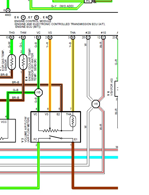

Also check continuity of each wire, especially the VS wire, back to the ECU. The reason I suspect a broken wire is because of how suddenly and completely the engine quit. A flakey VAFM would have bad spots and good spots, I think, and give you more of an intermittent problem.
Here's a snippet of the wiring diagram. Pins FC and E1 of the VAFM control the COR. Pin VS tells the ECU how much air is flowing. VC is at +5 volts, and E2 is ground. Pin THA sends an air temperature signal to the ECU.

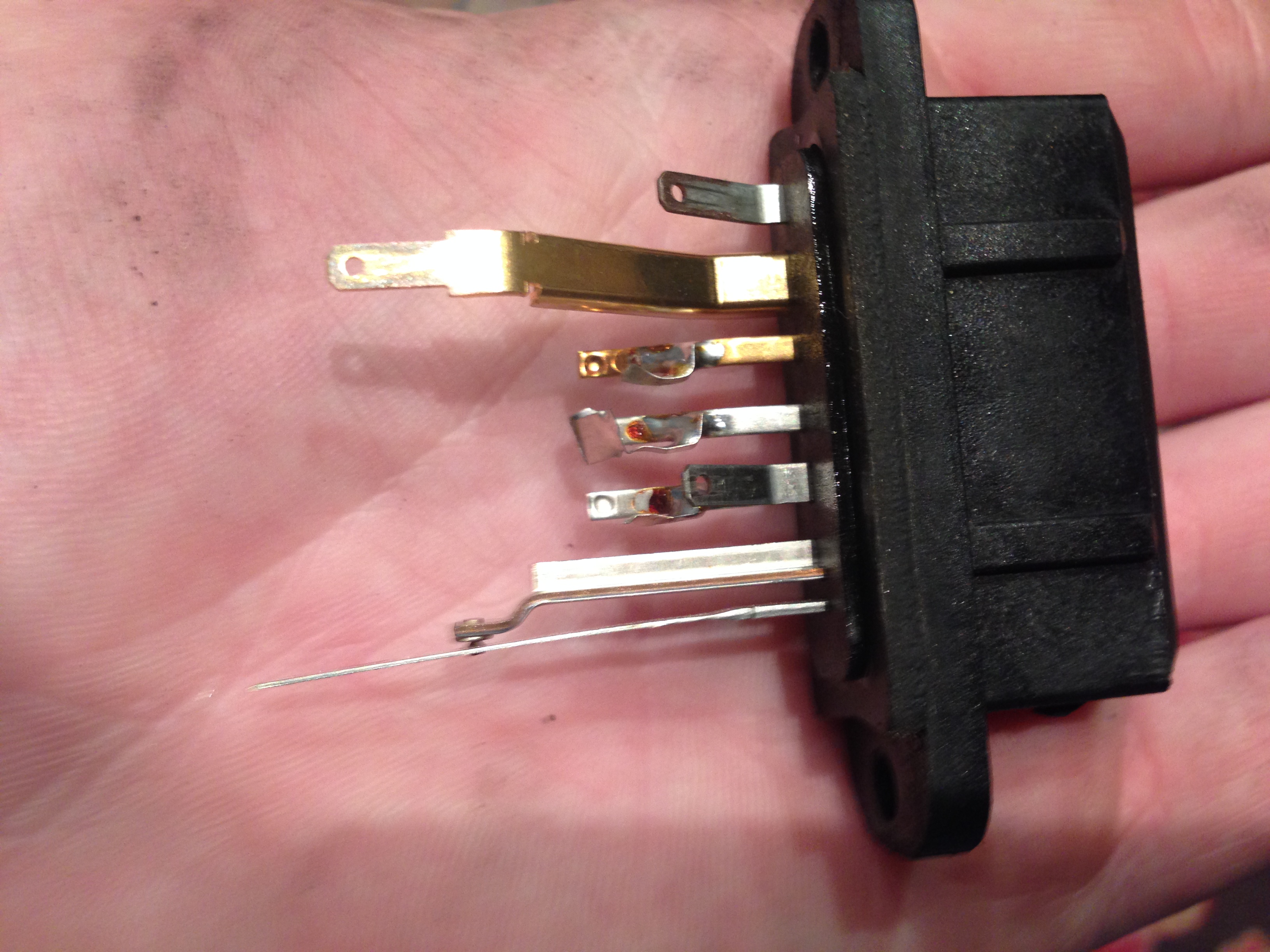

So my plan was to go through and check the wiring from the connector to the ECU this morning. Late last night, I decided to go back out and pull the VAFM again and bring it inside for another round of testing (just to confirm that everything was good with the meter itself).
Putting the meter through the FSM paces, I was getting erratic readings (sometimes the numbers were good, sometimes they weren't). Thus, I said to myself "Self, if the meter is bad, you're possibly going to have to replace it anyway. Since you don't necessarily have the capital to drop into a new one and even a used one would be a stretch, AND since you need your truck tomorrow, you may as well open her up and see if there's anything you can do to get this thing working according to factory specs."
So that's what I did...I cut out the silicone and popped that top right off. I figured, even if all contacts were good and everything was as it should be, it would still be a benefit to test everything, bypassing the "pins" of the connector..test the temp sensor and such directly from the board/wires. That way, if each individual component checked out from the inside, I'd be able to temporarily hardwire the VAFM to the wiring harness to get me back on the road this morning.
Well, to my surprise, none of the pin-to-board contacts were actually connected to the board. Sure, they were sitting in roughly the proper position, but they weren't actually soldered down to the board. The traces were all there, but one of the copper pads had come completely off (E2).
Long story short, I ended up risking it all and attempting to solder everything back up.
After a very tense 30 or so minutes, the soldering was as good as it was going to get, considering how large of solder I was using (and was using a soldering iron that was way to powerful for such small detail work).
Ran through the FSM steps again...SUCCESS. Solid (ish) numbers across the board. More importantly, consistent numbers. Ran through the steps half a dozen times and was reading identical each time. THANK GOD!
At first light, I put the ol' girl back together, said a quick prayer, and she started right up. Put her through her paces on the street and highway...she's purring like she should (maybe even a bit better than before).
Maybe this is why she's been running a bit rich lately...erratic signals (data) being sent to the ECU causing more fuel than necessary. May lean out the meter by a click or two before apoxying the cover back on...mabye.
For all those who doubt these things are fixable, my experience shows that if you break the contacts (assuming traces are still good, and you have a soldering iron and some solder, AND you have a steady hand and some patience, you should be able make it work. I had to dig online to find good photos of a pristine VAFM as reference, so here are some photos I took before and after...just in case it can help any of you in the future.
Many thanks to everyone who spoke up and helped me sort out the symptoms and such yesterday. I appreciate your time greatly!

That's great work, Ironsman! Glad it fixed your problem. No reason not to try when it's broke already.
The chances are someone tried to take the AFM apart by unscrewing the connector body and trying to pull it out, instead of cutting off the RTV sealant and popping the top. If you try to pull the connector body out, it will tear the traces off the PC board.

That's what I'm thinking too, Ron. I figure the Southern CA freeways (which aren't the smoothest of roadways) must have finally taken its toll on the already compromised contacts. I was slowing quickly when she shut down the other day, so the contacts must have finally had enough and shifted just enough, thus not playing nice with the ECU.
I'm going to carry my soldering gear with me in the truck for the next few days, just in case it needs a touch up, but so far, alls well that ends well. :-)

That's great work, Ironsman! ...chances are someone tried to take the AFM apart ,,,
Yes, same thought here, Ron. Pulled copper pad right off.
