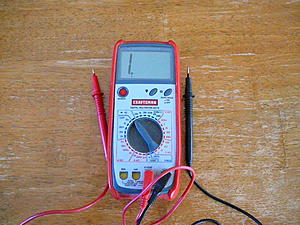

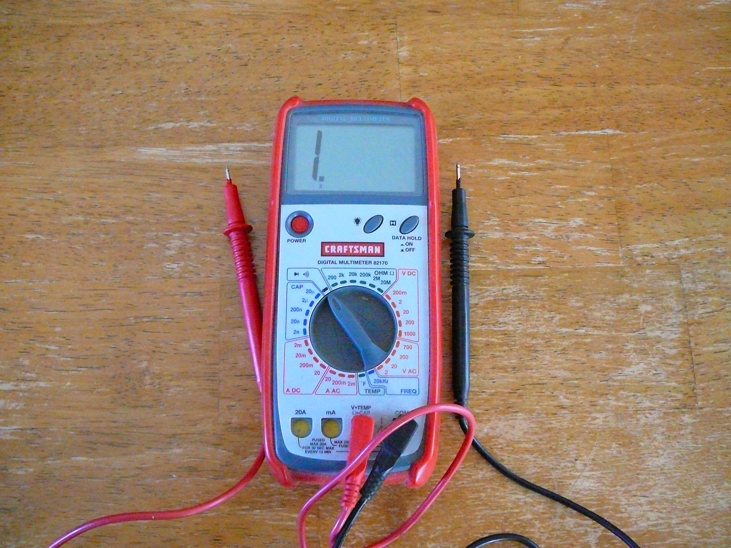

Old Mar 4, 2018 | 09:14 AM
  #39
Lexor15's Avatar
Joined: Jan 2018
Posts: 32
Exclamation Multi-Meter
Here is a picture of my multi-meter, just to make some of you happy. I've had it for over 20 years, and yes, I know how to use it. I bought this one because it beat out a comparable Fluke model during testing. It was still expensive, but well worth the price!
