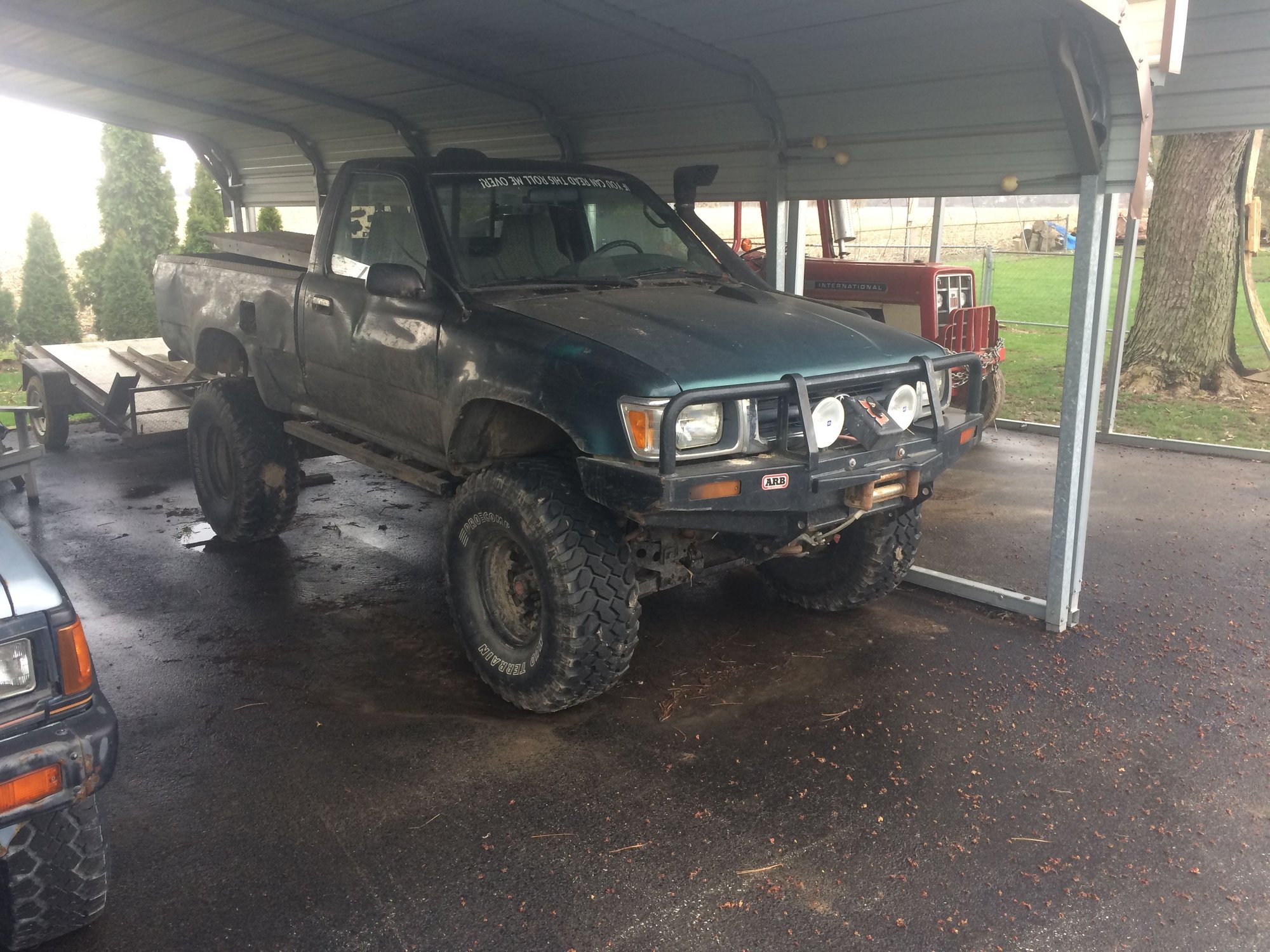

Hey all. Back after a long hiatus. Spent the last two years in Ethiopia. Back for 9 months to have a baby. There I have a 97 solid axle double cab hilux with a 3l diesel that I would love to turbo some day. Anyway back to my state side trusty old 94. 12 years ago I put an sds system on it and just got the tach working. Problem is the battery voltage gauge in the dash does not work and the volt gauge does not work. I had the cluster out and nothing seemed glaringly wrong. I have not checked the speed sensor yet. What is the usual culprit for this kind of failure. Its pretty much been sitting for 2 years.
