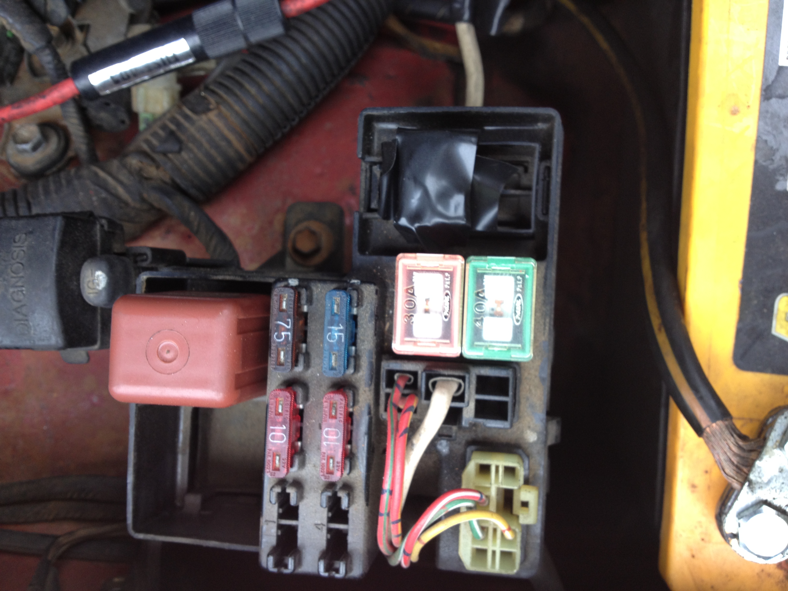

i am running an 89, runner 3.0 EVI
photo (3).pdf

The fuse block in your picture is the one under the hood. (by the way; any idea what the inline fuse at the top of the picture goes to?)
As Co_94_pu suggests, you need to look at the one by your left ankle. Unfortunately, the manual the three of us are looking at is for a '93, and there may be differences. I'll still bet the fuses have the same "name."
I know you've check the fuses, but what co_94_pu is suggesting is that you do it with a multimeter (with the key on). Test for 12v on both sides of each fuse. Why? First, a fuse can blow in a way that is not visible, or it can actually crack internally with age. Second, the upstream connection may be no good; no power in, no power out. But most importantly, you could have a good fuse that isn't seated properly. This is an easy check, with inexpensive tools.
Finally, don't ever say you checked "all" the fuses. You don't know where "all" the fuses are (I sure don't), and we don't care that "all" your fuses are good. We only care about two of them; if you actually checked them, you can jot down their names.

ok guys this is what i have com up with, see pics, sorry for the orientation of the pics i cannot get it to look straight
Old 04-12-2013, 12:41 PM
Luvmy89's Avatar
Join Date: Jul 2012
Posts: 35
Received 0 Likes on 0 Posts
Originally Posted by Co_94_PU
The door lock control relay is activiated with power thru the guage fuse. The primary power is provided by the "Power" fuse, number 14 in the page scope posted. This one is inside the drivers side kick panel, referer to the link scope provided.
Did you check with the ignition switch turned on? You only get the power from the guage fuse with the ignition turned on.
Doors, windows, the "better" diagram is in the door lock section.
Originally Posted by Sasquatch4Runner
I had this problem to, doors didn't work yet the sunroof and rear worked fine!!! The ANSWER is actually in the wiring that are in the door. So the black tube that you can see when the door is open connecting from the door to the main frame is wire housing and my hunch is that your wires have been broken due to the position and the constant wear of opening and closing the door. It's just been the years of use.
So with that said, get some screw drivers out, good flashlight, pop the door panel off, disconnect the wire from the main window/lock console, pop the black tube/wire housing off, oh and disconnect the wires from the fuze area from behind a panel by your left foot and basically get that bunch of wires out. It's pretty straight forward once you get going. Just be gentle with stuff given it's all wires, plastic housing and such.
So now that you have that line of wires out you have 2 options: Get your saudering kit (or however you spell it) and start cutting the area of the wires that are cut and replace it with new wire. Or option two... go to Toyota and pay probably $300, if not more for all new wires. I asked them to do it and they said it'd be a couple hundred so most obviously I didn't go with that option and did it with my grandfather.
Anyways I really hope this works out for you because I had this happen to me in the summer, not fun. Good Luck!
forgot the pics
Attachment 91887
Attachment 91888
Attachment 91889
Attachment 91890
Attachment 91891
Attachment 91892
