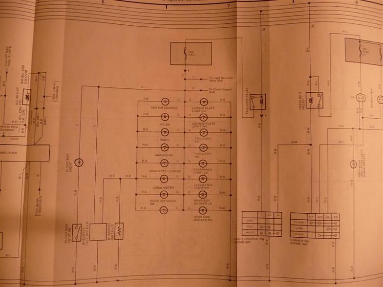

Power for the background lighting to the dash comes from the "tail" fuse through the tail relay (see the photo) and the power for the dome light comes from the "dome" fuse. It doesn't look like they cross paths except that they both ground on the left front pillar according to the FSM. The pictures aren't very good but the are readable, to me anyway. In the combination meter picture the rheostat has a red/ black stripe power wire and a white/black stripe ground wire. You could check for power at the rheostat and if it's there, ground the Red/black wire to have the lights on full bright or put a resister in series to dim the lights with only one intensity.

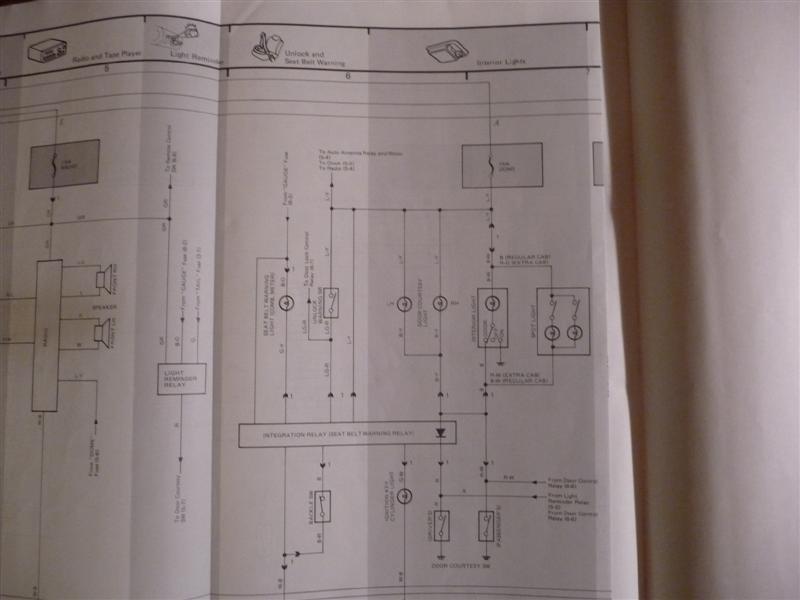

The dome light has a black/white stripe wire for power and a black wire for ground. Check for power at the b/w terminal. If you have power then the fixture is bad. If not, check for power out of the dome fuse. If there is power out of the dome fuse then take out the fuse and check for continuity from the unpowered side of the fuse to the dome light. This will tell you if the wire is burned up from bubble gum wrappers in the fuse slot.
The fuse is there to protect the wiring by blowing before enough current can damage the wiring. Unfortunately for you, by shorting the fuse(s), the PO may have damaged the wiring. By starting at the fuse you can check for power from one point to the next and determine where the bad wiring is.
Tracing electrical problems is an art so good luck and determination will win out eventually. Let me know if you need better pictures or pictures of any other circuits. These are from an '89 truck FSM but should be the same as the 88.

If that annoying "KEY IS IN THE IGNITION" buzzer [under the dash, above the steering column] has been unplugged, the dome light won't work. That buzzer is standard equipment on all rigs to remind you that you've left your key in the ignition when you open the door. Well, DUH, sometimes I WANT to leave my key in the ignition. The more useful buzzer "YOU'VE LEFT YOUR LIGHTS ON" when you open the drivers door, is only installed with the optional "Lighting Package." What were they thinking?
I've never had the key warning cause problems with the dome. In fact, I've cut the wire from the key warning on every Toyota I've owned (15+) because it drives me crazy and the dome has always continued to work.
The "on" position of the dome light is directly grounded and doesn't go through the integration relay or door switches. If that position isn't working, you have a problem with the bulb, the wiring or the fixture itself and troubleshooting like I talked about above will find it.

ok so i am sitting in the cab of my truck feeling overwhelmed lol. Bugs i am trying to follow the diagram but it looks french to me. I have no wireing experience unfortunately. when you say rheostat for the dash lights what is that and where is it?
