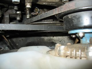

When I put the timing chain on, I had the cam timing mark up at 12 o'clock. You can't miss it. I also had the crank at 12 o'clock. I then turned the crank at least 6 times to make sure everything lined up. Dead spack on. Every time.
I think we can all agree that this is TDC.
You will also notice a certain very serious problem.
The link for the chain for the camshaft, is not at 12 o'clock. The camshaft timing dot, well, it's at 6 o'clock.
Prior to this inspect, I was able to rotate the crank by hand.
It is locked. The valves for #1 are under tension. I can now only turn the crank...not much. I took the cover off as you see here just for my (now third) post-install inspection -- just as a curiosity. I was not getting a spark on #1 (using the timing light) but #2, #3 and #4 were firing. Fuel was present on the sparkplugs.
