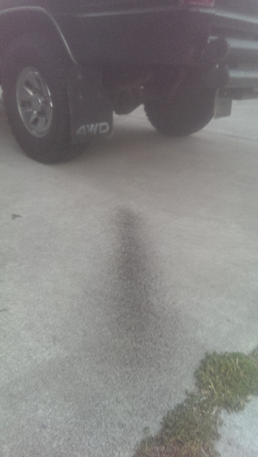

I've read the 4crawler tutorial on how to adjust my tps but but I am get the same problem with a new tps. Starts up first crank idles a little high, heats up and gets rough, give it gas runs fine a little rough at idle then I will get the same issue again with no power unless the engine can make it pass 2k rpms and the whole time it's trying to get power I get huge black clouds of smoke from the exhaust. I'm not loosing coolant I cleaned the whole throttle body all vacuum lines are connected right I cleaned the dash pot I cleared my ecu.

Here's what came out of my exhaust with the black smoke

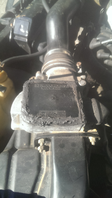

Here's a pic of my maf it seems to have been modded by PO but I'm not sure any ideas on this

Originally Posted by punks_is_4x4
Don't think that sealant is from the factory...
If your TPS passes all the tests on 4Crawler's page then you can assume it's working properly, for the time being. Seeing as the VAFM was tampered with at some point, you could always test it and try leaning it off a bit. Just mark its position so you can reset it if needed.

Any thoughts on how u would go about trying to cut throught that with out damaging anything?

razor blade, cut the excess of the top. you will then see a groove of sealant between the plastic cap and the aluminum housing. Carve the sealant out completely, and the pry the cap out with the smallest flat screwdriver you have.

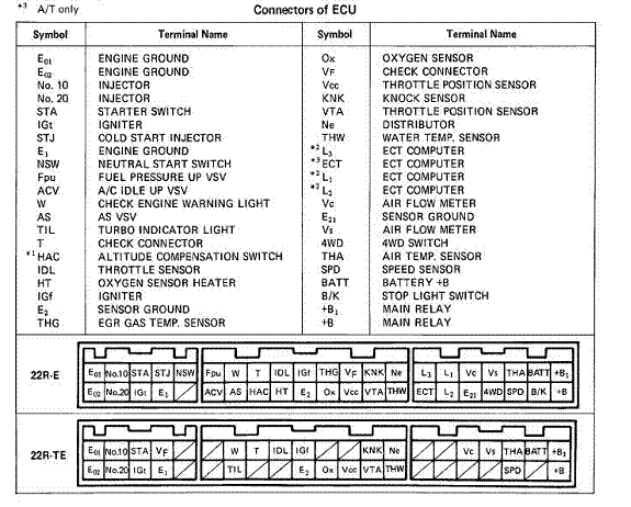

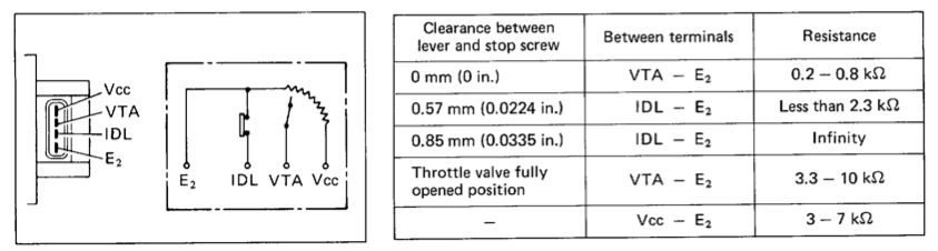

Did you use feeler gauges when you adjusted the TPS? The most important setting (from my own experience) is the 0.85mm IDL - E2 adjustment. Once I got that one right all my problems cleared up.
Also did you check the VTA throttle position sensor pin voltage at the ECU? Stick a multimeter probe in there and and one to ground... make sure that you're getting voltage. If you don't, you probably just have a bad connection somewhere. Should be in the range within 0-5V.

You're so welcome, I did it with it off. And the feeler gauge (or something similar) is a must.
I actually used a cut up credit card + a slice of 2ply paper to get the 0.85mm. I measured it with a caliper. But seriously just go grab some feeler gauges, they will be useful if you ever want to adjust your valves as well
Adjusting on the car would have been nice, but I don't have the allen bolts yet.
It seriously is like a hairline adjustment. Alligator clips on the end of your multimeter will make your life 10x easier in this case for that reason so you can leave it attached and find the .01mm where it loses continuity at 0.85mm
