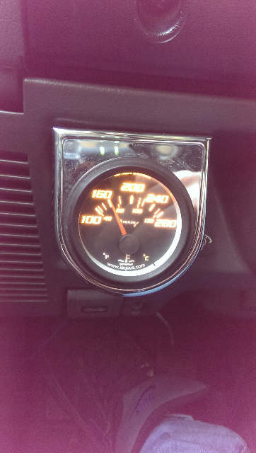

Well I didn't get to take it on the free way but I did drive the crap out of it trying to get it to fail again since I've adjusted the tps and no CEL so far. Here's my aftermarket temp gauge never gets past 160 really but my heater is blowing warm

So after all that at running temp it was at 1100rpms so I turned the idle screw down a bit to about 850 but when it's cold I have no high idle at all if anything a really low idle around 600 rpms.
So when I had the TB off I checked the aav like said working fine could it be the cold start timing switch next to the ect? I know the injector works

Hi punks
The aav or iacv cold idle up valve in the 86-88 22re's are prone to failure due to the unit having an electrical element on top of a mechanical one. That is the main reason I ditched it and went to 89+ intake- because it is fully mechanical and always works.
Anyway you might check the coil resistance for the aav. I forget what the ohmage should be, but it is somewhere in the FSM. I personally don't trust the old school aav's one bit... even when they check out per the FSM both mechanically and electronically they still barely work.
If you haven't already, it's worth a try to burp the coolant system. That cleared my roommates stock 87 idle issues up more than anything else. An air bubble is totally capable of throwing that cold idle up way off!
