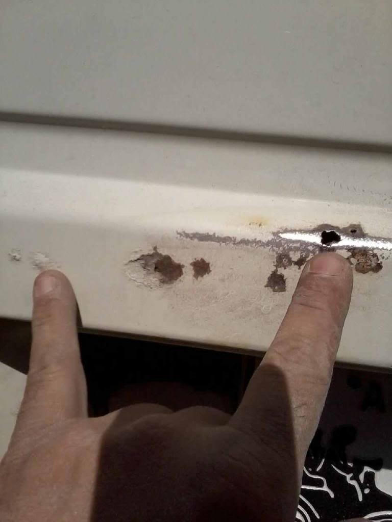

Pull the interior panel and make sure it isnt full of debri and the drain holes are clear. I have a tailgate that looks great on the outside but is about to fall apart at the bottom.
This tailgate is dent free, but was filled with dirt,mud,?? and looking inside of it, it is just a matter of time before it has big rust holes in it. It doesnt show to well but the area between my fingers is real thin and is rust underneath.
