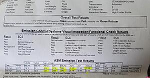

Just picked up a 93 3.0 4runner, despite it having a wide range of issues. Hoping I can take care of the majority of them without too many surprises.
First problem is going to be getting it to pass smog... It's starting up and running pretty rough until warm. Seems to have a couple bad injectors and I plan on swapping all 6 with some re-manufactured injectors from rockauto. I'll do the PCV while I'm in there. Timing is also off by 6 degrees per the prior owner. Couple questions I have:
1 - Any suggestions on things I should check for or swap/clean while I'm doing this?
2 - I believe I need an intake plenum gasket... does that sound correct? Any other gaskets or parts I'll need besides the injectors?
3 - Any other thoughts on the emission results? Obviously hoping I don't need to replace the cats, but figure starting off with getting it running properly is the best move.

Wow. 399 ppm HC; I'm surprised you could even see the smog tech with all that smoke. Well, you've got passing (though not that good) NOx numbers, which would otherwise be much harder to fix.
First, in California it is legally the responsibility of the seller to pass smog. Yeah, yeah, even I once bought a truck knowing it didn't pass smog. But if push comes to shove, you are entitled to get your money back.
Here's a technical article on emissions. http://www.cygnusx1.net/Media/Supra/...taTech/h56.pdf High HC combined with high CO generally means you are running rich. WAY rich. My guess is that you've got more than one cylinder missing (when the cylinder doesn't fire, it dumps all the HC into the exhaust). I'd start with the plug test; at idle, pull each plug wire one at a time. You should get an rpm drop with each wire; the ones that don't give a drop are suspect.
Next, pull each plug and look at it. Wet? Black? Sooty? It's possible you have a stuck-open injector, but not too likely. Is there any other reason you think you have bad injectors?
Very generally, bad gaskets can lead to vacuum leaks, which often lead to a too-lean situation. You have the opposite. (It's not quite as simple as that; if you have a vacuum leak the extra O2 can fool the ECM into thinking you need more fuel. Watching the output of the O2 sensor could help.) Is there a reason you think you need a gasket? Have you tried testing with an un-lit propane torch? If you're serious about the injectors, it doesn't matter, because you'll have to replace that gasket on the way.
The good news is that once you get the engine running more-or-less correctly, smog is easy. With my '94, my last smog check was 8ppm HC.

Good advice above.
I'd check for codes and write them down.
Get the timing set. If it was advanced to compensate for a underlying issue you will have to track down why.
Does it look like the prior owner was fairly responsible about maintenance and oil changes? Personally, I'd pull the valve covers and make sure I didn't have oil build up.
Since you just acquired the vehicle it never is a waste to replace spark plugs, wireset, cap, and rotor. I’d getting Denso only. Except for the plugs:either Denso or NGK. If you Google "Denso find my parts" you can see all they offer.
I highly recommend trying to leave the catalytic converters alone for now. First, it's pretty rare for cats to be the root problem. Usually something upstream is contaminating them. Once you fix the main problems factory cats will usually clean up. From my own personal experience I can attest to the disappointment in quality and durability of aftermarket cats. No wonder the Bureau of Automotive Repair regards them with disdain.
Once you find and repair all the driveability issues it never hurts to go into a smog test with fresh engine oil and a tank of 91 octane Chevron or Mobil.
