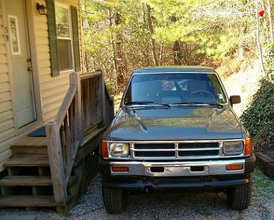

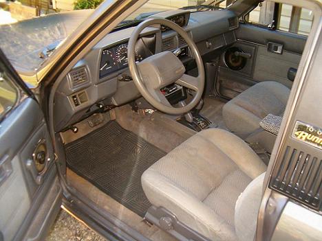

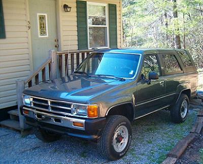

Hey fellas, glad I found you all here. This is my first 4runner and wanted to see if anyone would chime in on a few Qs I have. I paid 1900 and feel it was a fair buy but whata you guys think? It shows no signs of an accident and no rust at all and the int is in really good condition. I had to tinker with a few things, thanks to your forums I got the rear window working again. The window lock button had been bypassed and the wires were a little loose. The temp guage wasnt working but the wire at the sending unit was a little cracked. The speedo/odom isnt working so thats on my list too. I was gonna have the cat conv cut out, but when I went to the parts store for new wires, plugs, cap and dist, the guy showed me the parts I needed to do it myself so I replaced the exhaust from the cat back all for 90 bucs. I saw some other threads discussing exhaust and I hope the members see this thread so I can tell them that there is nothing to it and you can easily do it yourself and save money on the labor. It had some leaks where new and existing pipe met but muffler mender took care of it nicely since I dont have a mig machine. I read a few threads discussing steering/shaking problems, but mine is pulling to the right with a slight chatter coming from the left front wheel except for when I touch the brake pedal, then it stops. And when I get to around 50 mph I get a shake in the wheel. I see someone has rotated the tires front to back and there is a shade where a weight once was on my front right wheel, maybe it was balanced and taken off for that. I know I need to get them all looked at as far as balance goes. Anyone that can feel free to chime in on your take on that subject. And how does the top come off? Ive searched plenty and cant find anything. I see the four bolts inside where the top meets the cab roof but what else is there to it? Ive included some pics so feel free to give opinions. I just bought this to save on fuel over my c1500. Im sure gas will hit 3 a gallon this summer and that aint cool with a v8. Its a kick in the ass to drive and my dog loves it, she thinks shes all that cuz she is riding inside. Any imput really is appreciated and if I can help any of you with diet/nutrition/strength training lemme know. I moderate on a bodybuilding/powerlifting forum and have been in the game for roughly 10 years. Thats not spam I just dont like coming to the table with nothing to offer is all.

First of all, what year is it and which engine? Auto or manual tranny? Options?
If you haven't purcahased the ignition stuff yet, I'd highly recommend www.sparkplugs.com for great OEM Denso and aftermarket NGK wires, distributor cap, plugs, etc. Go with OEM denso or NGK for the best results. DO NOT ge Bosch ignition products; these engines don't like them.
For the chatter/shake, I'd put the truck up on jack stands, have a buddy hold the steering wheel, and try moving the wheel with your hands on the 12 & 6 o'
clock positions, then the 9 & 3 o'clock positions. Really give it a shake. This will tell you right away if their are any major front end problems. Could be a tire out of balance, but it reads more like a loose axle nut or worn tie rod ends.

I say you got a decent deal for $1900, it looks nice. As for the shake, hard to say, I'm with TNRabbit but as with all front ends it could also be as simple as worn shocks. For the chatter; if it stops when you touch the brakes then that's where I'd start looking, brakes, rotor, wheel bearing etc. Start on the outside of the wheel/steering spindle & work your way in. For the top, as far as I know the bolts are the only thing holding the first gen tops on, but you must be sure to apply the proper torque when putting it back on or it will leak from what I hear.

Hey thanks Rabbit. Man I thought I had included all that. Sorry, its an 87 with the 22re and auto tranny with ECT. I really wish it had a 5 speed. No power options but it has a working tilto and alto on the dash. I installed the ignition parts a few weeks ago and it runs better but its no speed demon ya know? And thats cool Im never in a hurry I just need economy at this point. I was planning on getting under the front end as soon as this damn cold and snow gets outa here. Been spring like for a month and now Im looking out the window at snow falling.
