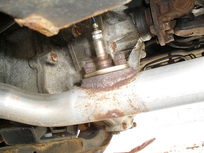

i was offered a great deal on a full exhaust incl. cat and muffler, supposedly from stock exh. manifold back, for $400 installed. i asked twice if it was all stainless and told yes. ok so i bought it.
they called me during install to say the kit didn't have an o2 bung in OEM location, and they'd have to cut in a mount. ok, i approved.
when i picked up the truck, it sounded and looked great! off i go.
just now, while taking pictures underneath for another thread, i see this crazy custom fabrication:
1. smaller diameter, not stainless, 02 mount. already surface rusting. REALLY?
2. LOOKING FORWARD FROM JUST BEFORE THE 02 MOUNT. STAINLESS ENDS AND GOES INTO WHAT? IS THAT MY OEM DOWNPIPE? you can see the manifold flange in the distance.
is it worth complaining about these two pieces being cut into the system? i'm suspecting this was not for a 4runner chassis.

I'd definitely bitch bout the 1st pic...2nd pic im not too sure if i'd bother...depends on they way they worded it when they sold it to you...the downpipe may be considered manifold to them...
the 1st pic looks like they just hacked your existing o2 mount out and welded inline...

I'd make them do it right, but you also told them to go ahead and use the old bung. Gonna take a fight...

you said use the old bung, not the pipe. make then use a hole saw and cut out the bung and weld it to some new pipe..

I'd take it back, that's kind of crappy how they welded an old rusty pipe into your new system. I had my exhaust welded up by a local shop but I re-used my muffler. They ordered a new 02 bung and they did re-use the connector to the manifold but they cut it off right behind the dual pipe flange thingy. And I paid $127 out the door. I did supply the cat and O2 sensor though so I suppose your price was decent. Like people have already said, the downpipe probably isn't that big of a deal but the O2 bung and old pipe would annoy me. I'll snap some pics of mine in the daylight if you want.

thanx for these pics. your 1st pic is what i was expecting them to do. reuse the mount, not the old pipe it's attached to.
i'm going over there tomorrow to resolve this. thanx for confirming i'm not being overcritical.

That definetly is B.S. the front HALF of your front pipe is just the old downpipe, welded on to a small piece of stainless. Its not a complete stainless setup if they have to weld into the existing section of downpipe.
He also said manifold back. Not "just in front of the cat...back".
