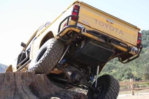

Originally Posted by Zeb8806
I really like my LC coils they flex awesome. Right now they are allowing to much travel, the drive shaft is hitting the gas tank even with the panhard drop bracket. Im gonna make some limit straps to solve that issue. I would say if you plan on staying in the 3-4 lift range keep the coils. Any higher and you would have to lengthen the links.
I don't have a runner but if I did I would set it up like this, I was with him at rausch creek where this pic was taken and that thing could flex!
I agree, was there too. Scary even, although the truck was "stable" it flexed so much, I swear he was gonna roll. But that driveshaft made one heck of a racket.
