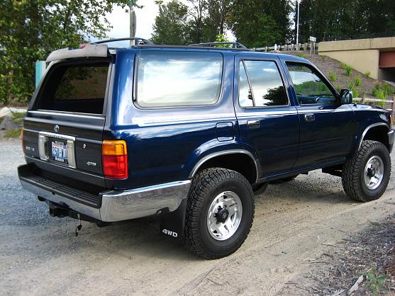

Bingo! I like it. So now I have a game plan, I was seriously debating putting this back up for sale, but this is a much better idea. I would have been sad to see it go.
Attached Thumbnails New 95 4runner - Stressed.. Need advice-front2.jpg   New 95 4runner - Stressed.. Need advice-side2.jpg

dag on lithium. thats one of the most clean stock 2nd gen runner ive ever seen in my life. nice runner!

mother of god that's a clean runner... a 3.4 liter swap worthy vehicle if I've ever seen one... well, that is of course if it's a 5-speed. It's reasonable to expect anywhere up to another 100k on the head gasket if the job was done well and you take good care of it, you can keep that 3.slow for a good long while. I totally agree on the getting the 3.4 as a whole donor vehicle or a 'front clip' so you know you have absolutely everything you need. The 3.4, even if you do find all of the conversion parts, will take an ass-long time to do right. You need to come up with a wiring harness, a custom fabbed exhaust system, and other busy work you could and probably should do yourself to save some cash. If you're diligent and careful, you can save yourself a grand or two on labor.
