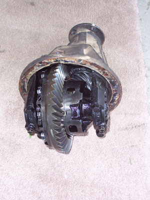

Well, over a month ago I pulled my diffs out and had them sent to ZUK in AZ. I decided to go with 529's. I didnt really see many people running them and thought it would be interesting to try something fairly new(with 33's BTW). ZUK said it should be fine as well. I also had a Lock Right put in the rear.
Ive put about 300 miles on the rear so far and only about 10 miles on the front. I was expecting a little more out of the 529's but I cant ask for too much when it has a 3.0 in it. It revs a little higher but not much really. The locker took a little a getting used to but its no big deal now. I was scared to take it on the highway but after doing a few short trips, it seems to handle just like it did before without the locker. Its true that you only notice it a slow speeds while turning(at least for me). Now I just need to update this after my next trip to see how she handles offroad!!
Overall, I am pretty happy that I regeared to 529 and the locker hasnt been in long enough to really say. Now I just need to get this dang o2 sensor problem fixed!!
I got a few pics I can post too.

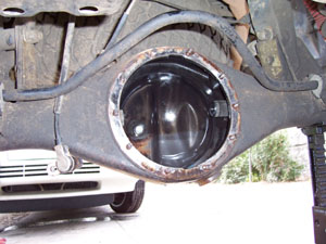

3 from the rear
Here are 3 from the rear. i will work on uploading the ones from ZUK of the install
Attached Thumbnails New 529's and a lockright!!!-rear1.jpg   New 529's and a lockright!!!-rear2.jpg   New 529's and a lockright!!!-rear3.jpg

Automatic tranny?
Getting that rear under the sway bar and into the housing is fun, huh?
