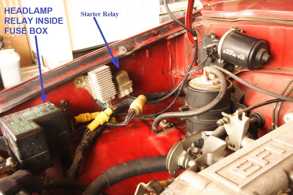

AND...You mean you see, hear, feel nothing at all?
Also we are thousands of miles away from you. It would help if we could see what you have in front of you. Why not post pics. Either we see pics or you really don't have a Yota and you're just testing us - LOL!
For example does the truck have a starter relay?
