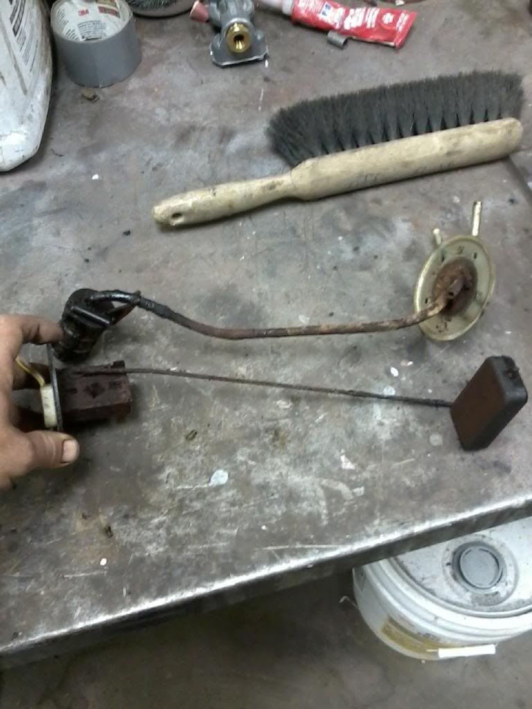

Sounds like it is starving for fuel. There are 2 filters on a 22r. One is just outside the tank, under the bed attached to the frame. The other filter/strainer is located at the end of the pickup tube on your fuel pick up assembly in the tank. I have seen them get a coating or a crust built up around the filter/strainer that will cut down on the amount of fuel that can travel.
Copied from my thread.
Part number for a new intank filter is #77023-12050. On ebay it is called a TOYOTA FACTORY NIB FUEL FILTER SUCTION TUBE DIESEL. It was selling for $4.50 when I finally found it. I paid $15 at Toyota. (83 pg 8) This filter is for carburated trucks.

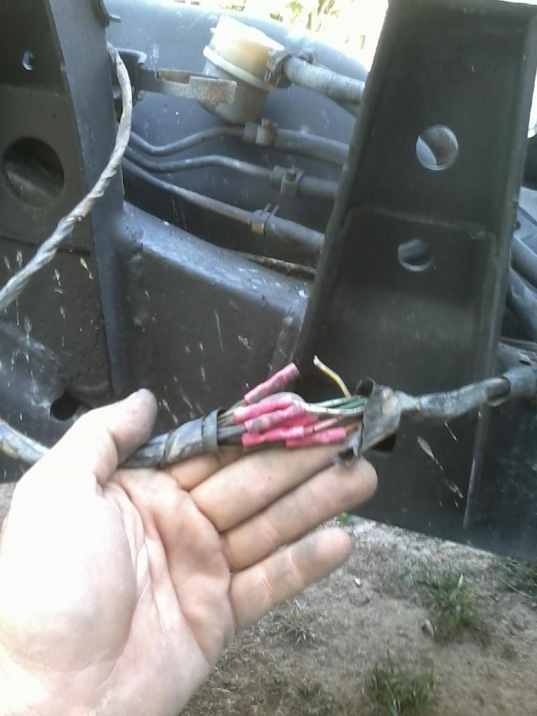

External 22r Filter.
I knew I had a picture of the factory filter somewhere. Ignore the wonderful wiring hack job.

Clogged internal filter.

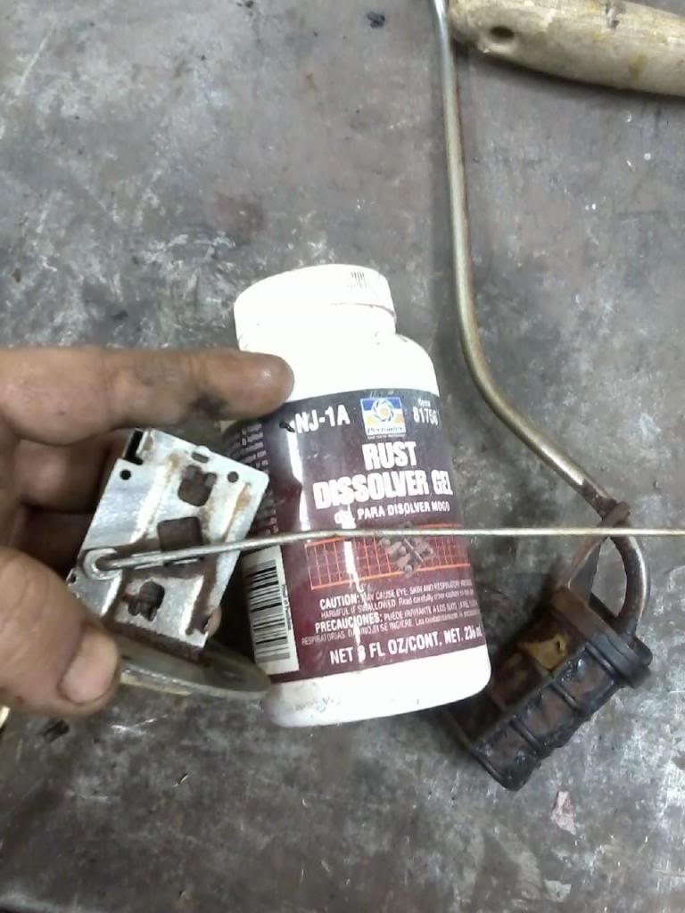

The float was frozen solid. I put the rust dissolver on it and had it working in 2 minutes. I am really starting to like this brand over PB Blaster. Here it is frozen up with rust. Fuel filter is hard as a rock also.
