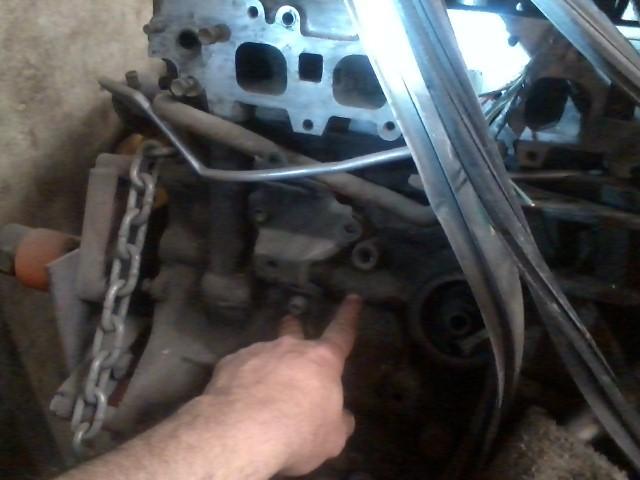

Here is another way to see if it is 85 or newer. If it has the bolt holes for the Fuel Filter Bracket and the Knock Sensor just in front of it. If it does not have these it is 84 and older.

Thanks again Terry, I'm on the way to pick it up. . If it is a late model.
That knock sensor will probably be easier to see & keep me from having to crawl around in the snow to check the t - chain cover.
