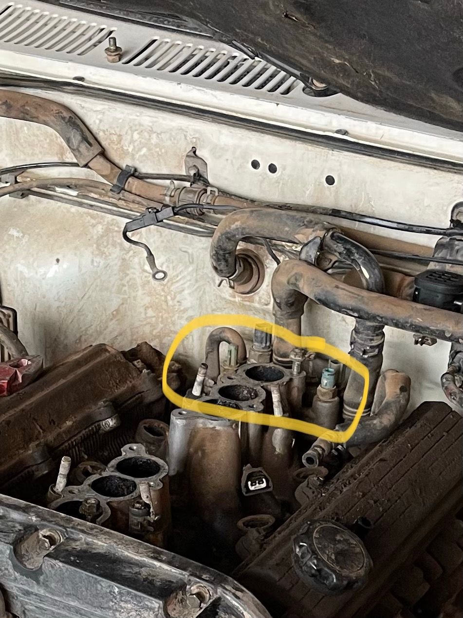

As the title states I need help identifying a part. It’s located top back of engine it’s the housing that the bvsv screws into along with other sensors. And if you might know where I can order one or find one. Any help is appreciated.

Seems I found what it is “water bypass” anyone have ideas where I can order one?

You might try OReilly.com? They normally have odd parts like that. Otherwise I would suggest a junkyard.

Outlet, Water Bypass 16351-65040. Long out of production, but this Japanese distributor https://yoshiparts.com/parts/toyota-1635165040 lists a price for it; you could try an email.
That part varies a lot depending on equipment: e.g., 4wd Automatics have an additional temp sensor, so the bypass is different.

Yoshi won't be able to get. And seems a bit of a stretch for aftermarket..
I think wrecking yard is the way to go.
In Calif that'd be pretty easy to find at a PYP yard.
