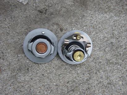

I had overhauled my cooling system--replaced it with a OEM water pump & tstat and off-brand radiator and hoses and my truck had almost the same symptoms as yours. After searching YT, I found out that I needed the tstat that allows constant coolant flow. I forget the part number but it's somewhere on the site. It's a tstat that has two openings on it--one big, one little. After replacing it, it worked fine. Actually, I have a couple pictures of the two different tstats.
Attached Thumbnails Need Help Fast With Overheating Issue!!!!-dsc08109.jpg   Need Help Fast With Overheating Issue!!!!-dsc08110.jpg
