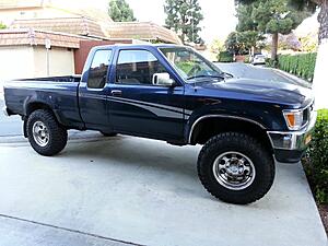

Coolant expands when hot, so the reservoir is also an expansion tank. Thats why you have hot and cold levels. You may already know this, so please dont get offended if so. Working out problems will give you valuable experience and confidence. Your truck looks nice. I miss my 90 with 3.0.
