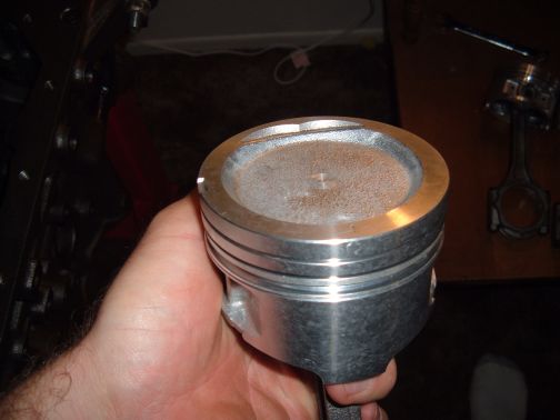

Yes, both the pistons and combustion chambers are different.
Installing a Stock Yota Turbo to a 22RE
RTE head. Though the chambers are hard to see.
Old Nov 17, 2010 | 08:32 PM
tried4x2signN's Avatar
Joined: Jul 2008
Posts: 1,818
From: Nashville TN. I can help you if you're close BUT NOBODY CAN HELP YOU IF YOU DON'T FILL YOUR LOCATION IN!
If I was gonna put a RTE together, and wanted to add some pep. I'd either use RTE pistons with an RE head, or an RTE head with RE pistons...
And it'd be the latter... (B/c the head should flow better)
Oh, and without a doubt I'd get rid of the CT20.
