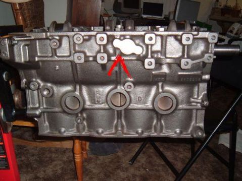

Oil feed: On the passenger side, there is a plug behind the passenger side oil mount. I believe the threads are M10x1 (off the top of my head) - please confirm - anyway, this spot is pre-tapped as an oil feed. Alternately, you can "T" off of the existing oil pressure sender. I have some photos of these spots if you need them.

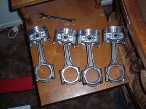

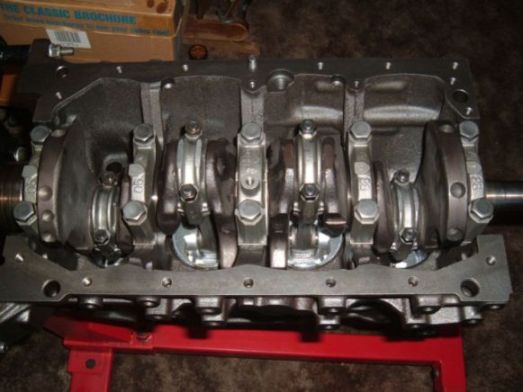

Did you do this motor build yet? If not, you really ought to put forged pistons in there while you're rebuilding. They will cost you a bit more up front, but allow you to run your setup to the limit without causing catastrophic engine failure. They will tolerate a moderate amount of detonation prior to failing, while stock toyota pistons will generally handle nearly nothing before they explode.

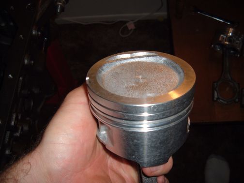

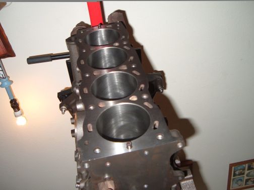

Still working on this project. I have got all of my engine and parts back from my machinest and have started to assemble the engine. I will post more and more as I get closer to ignition in the vehicle and will go over the tuning process. For now I have included some pictures of the new block, Pistons and rods. Notice the deep dish in the pistons. Definatley going to lower the compression ration a bit from stock. So far I have used Plastigauge to check all of my oil clearances for my mains and rods and am absolutely impressed at my readings. Both the mains and rods are at .025mm, which is the minimum for a 22RTE. Plastigauge is a very simple measureing device and if anyone is unfamiliar with it and wants to learn more please ask and I will explain what it is.
Attached Thumbnails Installing a Stock Yota Turbo to a 22RE-pistons.jpg   Installing a Stock Yota Turbo to a 22RE-pistons2.jpg   Installing a Stock Yota Turbo to a 22RE-pistonsinstalled.jpg

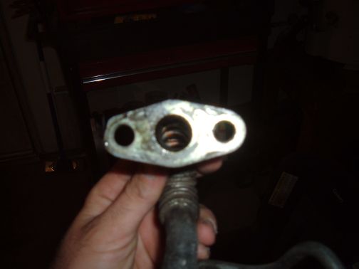

As for the turbo goes I am going to send it in to Turbo City and have it rebuilt in about a month or so. It is 327.00 for a complete basic rebuild, meaning no broken parts so on. The pictures below show the 1/4inch plug in the oil galley that is just down from the threaded hole for the sending unit wich I plan to use as an oil supply line. I am going to have to run it around the back of the block with the other water pipe and the EGR pipe. the return will be the flat spot in the center of the block in the other picture. The turbo has a pipe for the oil return that has a flange that is the same shape as the flat spot. I am going to drill a 1/4" whole and tap two wholes for the 8 or 10mm bolts I will use. I have also included a picture with the crank and pistons installed. ALWAYS REMEMBER, LUBRICATE-LUBRICATE-LUBRICATE!!!!!!!!!!!!!!!!!!!!!. I use Assembly lube on all my bearings and bearing surfaces. I also coat the cylinders and rings thuroughly with 10-30w motor oil to help avoid scoring of the cylinder walls when installing the pistons. I also take two pieces of rubber hose and put them on the rod studs when I install the pistons in the block to avoid knicking the crank, this would be bad bad bad. Also the best place to do the rebuild if you do not have a nice clean garage is in the old living room. Better buy the wife some flowers!!!!!

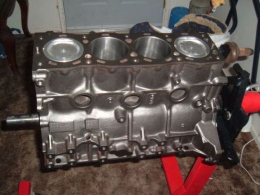

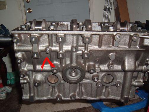

Last but not least here is a photo of the block after the machine work was done before I installed the pistons. Also i have included a pic of the oil return from the turbo to help show what I was talking about earlier. Agin look at he shape of the flange and the bare spot on the block and notice they match.

As opposed to that stock oil return you may consider a gasketless AN style fitting. Using toyota proprietary parts when you don't have to only complicates repairs in the future. I make aftermarket turbo oil line kits for other toyota blocks and always make sure to do away with the OEM parts in the case one of my customers breaks down on the highway somewhere and doesn't have a toyota dealer nearby

That's a purdy block
I'd defonitly reccomend not using the stock return line, if only for ease of routing. I'm currently working on using a T3 off the stock manifold(using an adapter), and because the turbo is mounted so close to the return port, it makes conecting the two(with a good flow angle) very difficult.
If you have to tap something, you may as well tap the oil pan. You're going to have to do something custom for the feed line anyways, so it wouldn't be that much more(if any) work to do it to the return.
Good luck, and defonitly keep us updated.

Tapping the pan is a good option. Depending on how you are mounting the turbo will determine how useful the stock return is.. The higher the turbo, the more useful the OEM return is.
You can adapt it to an AN style fitting with a little brazing.... The stock return isn't likely to fail.

Any gasket is subject to failure. Any time I can go to a gasketless fitting I assume higher reliability: AN oil and water fittings, V-Band exhaust pipe/turbo fittings and Wiggins Intercooler/Air Vacuum hose fittings. You will notice all high end automotive applications (race teams, etc) use gaskets as little as possible

It would take a lot for that particular gasket to fail though. It's a gravity fed return...blowing the gasket would be quite the sight.

You don't "blow" oil return gaskets. They fail from heat and decay (particularly heat in turbo applications, especially on vehilces that are used in low airflow situations, such as off road). I've got an entire box of low-mileage oil return gaskets I have pulled off customers cars that failed....I'll sell them all to you for only $5 ea, should be as good as new since they never see any pressure

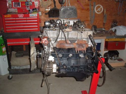

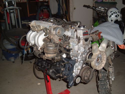

Oay I am keeping and finishing the Turbo. I was able to raise some extra cash and no longer need to sell the Turbo set-up. I am glad as I really have put a lot of work into it and was bummed to let it go unfinished. I have assembled almost the complete motor now. I bolted the used factory turbo exhaust manifold on and it cracked in the center where it had been repaired- not a good job. I plan on repairing it correctly. I then ran into a problem with the turbo housing hitting the water pipe on the left side of the block that runs next to the block. If I keep the stock manifold then I am going to have to cut the water line and re route it with a flexible line around and away from the turbo. I still have to have a supply line and drain line made for the oil feed/return but am planning on using something from Earl's line. I also have run into the a problem with the existing EGR feed tube that bolted to the stock exhaust manifold. I have no where to bolt it now and am going to need to figure something out. I also believe that there is a sensor or vaccume switch that was on the originall manifold which is not on the turbo one. Again I have to figure this out for California SMOG. Anyways I will post some more pictures for those who are interested and keep everyome posted up to D day. and hopefully that won't be destruction day!!!!! I will post some pics soon, Travis.

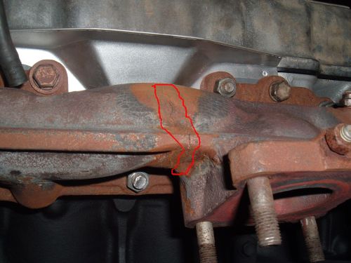

Here are a few pics for now. Notice the cracked area on the manifold.
Attached Thumbnails Installing a Stock Yota Turbo to a 22RE-exhaust-man1.jpg   Installing a Stock Yota Turbo to a 22RE-exhaust-man2.jpg   Installing a Stock Yota Turbo to a 22RE-getting-close.jpg
