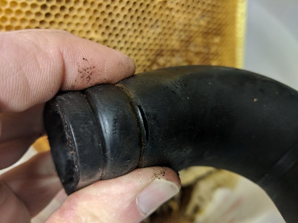

"Dripping from bottom of alternator" -- yep. Mine did that. Leak was from the hose-to-pipe connection above the alternator. It'll eventually trash your alternator. Replace that hose, and be ready to spend some quality time removing the corrosion on the pipe before you install the new hose. See how mine developed a slit failure? Also, there was a lot of corrosion inside the hose.
