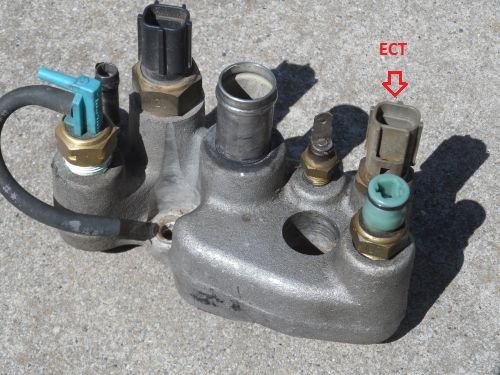

Bolted to the back of the head is this gadget:
The large tube is part of the heater system. Here's the manual section that describes it: https://web.archive.org/web/20141114...06operatio.pdf
There's a gasket below the gadget where it bolts to the head, and all of the sensors could leak, but I'm guessing you just split the heater hose.
So all you need to do is get it up to temperature and look for the leak, eh? No, you'll scald yourself for sure. Take the easy way out and pick up a cheap coolant pressure tester like this:
Amazon Amazon
Then you can pressurize the system cold and finding the leak will be easy.
