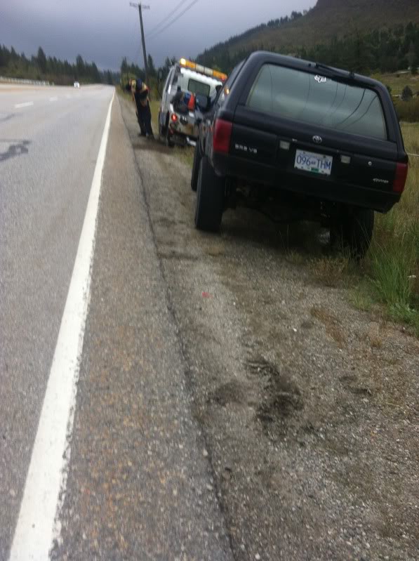

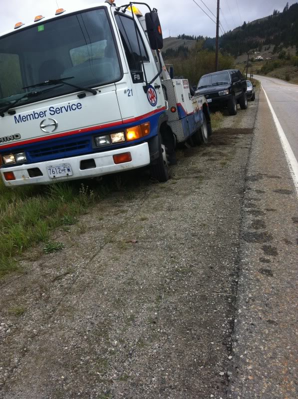

Yea it was a good time, im just glad the truck didnt cause a huge accident and I can still drive it. I got some pictures gathered along with a couple I took during the retarded recovery process. The tow truck driver got his truck stuck as he proceeded to back up more so into the soft ditch instead of right up to my truck, so i watched him try and dig it out for an hour before he called out a 5 ton truck driven by his boss to pull him out. It was rediculous

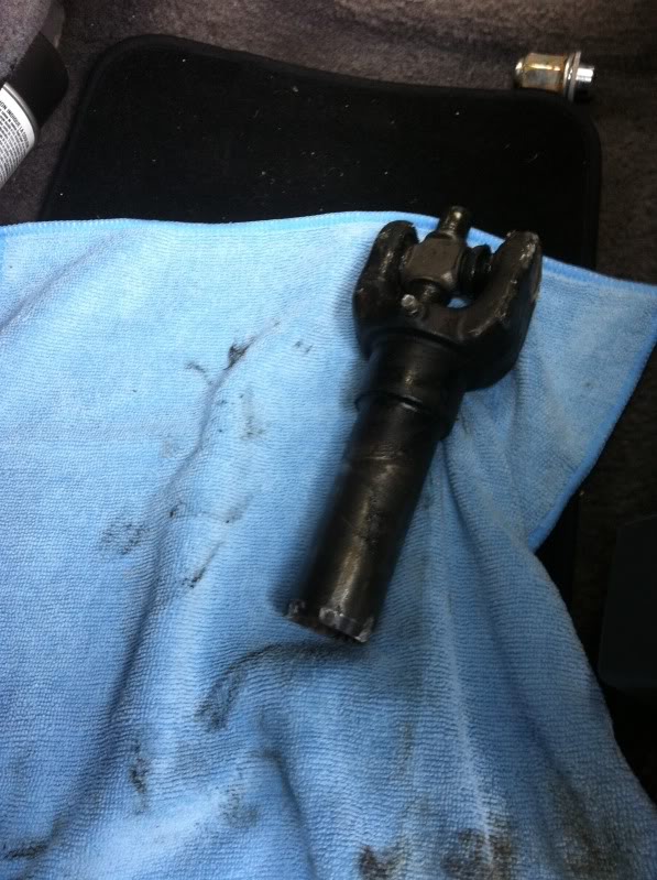

This is the only part i was able to find and it was a half km away from my truck

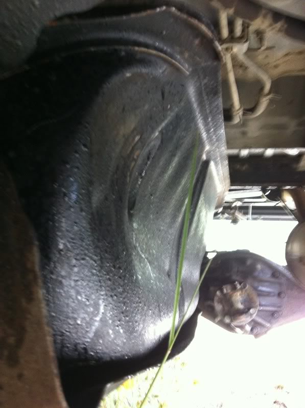

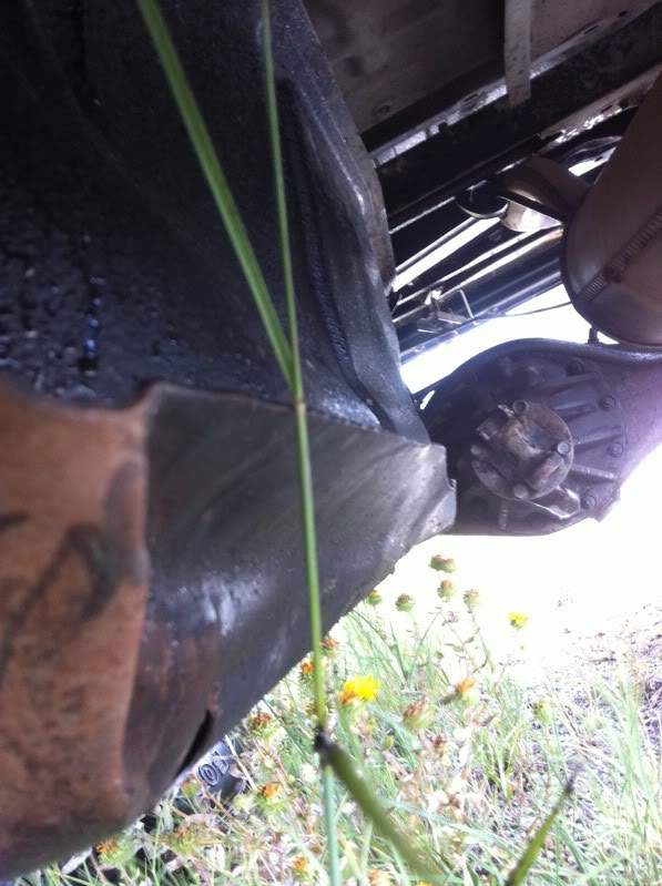

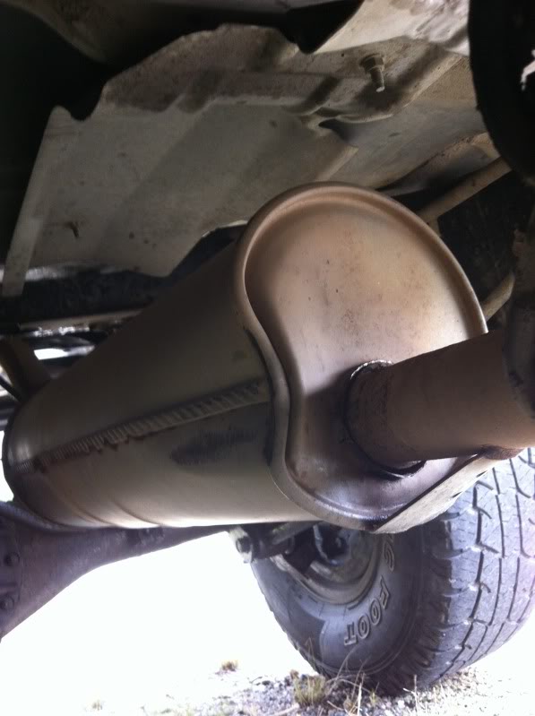

Took a couple good swings at my muffler, gas tank and gas tank skid plate before flying off my truck into traffic behind me

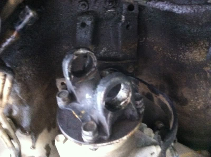

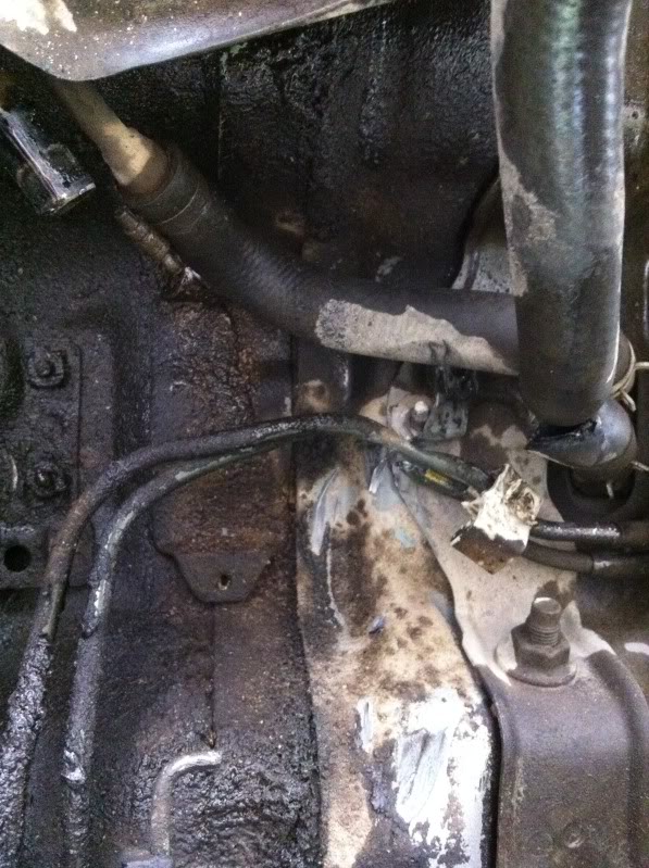

Hard to tell, but both fuel lines are fubar along with one of the trans cooling lines

My excellent tow truck driver and his 2wd ditch rover

Possibly, it looks like the yoke ear failed on the differential end (third pic from top), IMO. Did you crack or bend it when driving out or in the U-joint?

Third pic from the top i the t-case end, i havent taken a very close look at everything yet but theres a chance one of the ujoints failed, im off to find a used driveshaft after work today so hopefully i have luck, the gas lines and coolin hose will have to wait a day.

....looking back towards the rear diff where the ear appears sheared off possibly from the d-line flopping around or possibly the cause....hard to say.

I think the joint at the pinion flange failed, elongated the slot and went from there..
